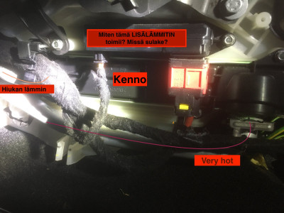

Citroen C4 B7 2012 HDi 1.6 electric cabin (auxiliary electric) heater. How should it work?
Where's the fuse? How to test if the resistor of this heater is working?
In the picture, the heating cell is under the circled electric heater.
It is a two-zone air conditioner. Which engine adjusts the hot/cold flaps.
Is it normal that both pipes for the heating cell are burning when the fan is off? But when the fan is on, the supply pipe is hot and the return pipe is only slightly warm. Should both pipes always be hot when the engine is warm?
