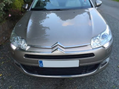

Can anyone tell me where can I find the headlight tilt regulator? I've checked my manual and it is supposed to be in the steering column, but I can't see it anywhere. Even searched all over the car. Are these automatics or am I really THAT blind?

It's here - number 20 on the picture (apologies - it's not clearer). Located on the left of the steering column on a RHD.
Note: This is assuming you have halogen headlights. If you have Bi-directional Xenons, you don't have the switch as the levelling is undertaken automatically by the headlight levellers independently. If you have Xenons, they will be like mine below:
Sorry if you know all this, but yesterday we had somebody that didn't know if they had Xenon's or not.

You only get the adjusting switch if you have Halogens AND steel spring suspension. If you have wet suspension then there is no manual adjustment for either type of lamp.
Just noticed it's an Exclusive so that'll make it a wet suspended vehicle.

Paul's quite correct - I forgot to mention that the hydraulic C5s are of course self-levelling load-wise, leaving the headlight motors to adjust for the pitching, which the suspension can't compensate for quickly enough, so as not to dazzle oncoming traffic. Thanks for clarifying Paul.
