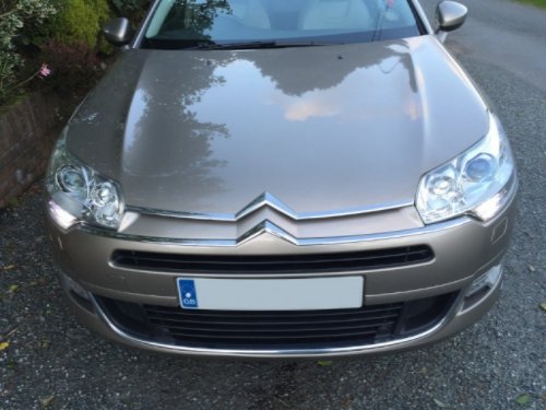

Note: This is assuming you have halogen headlights. If you have Bi-directional Xenons, you don't have the switch as the levelling is undertaken automatically by the headlight levellers independently. If you have Xenons, they will be like mine below:

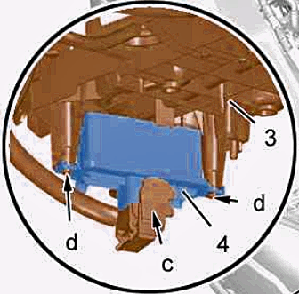

The Headlamp beam correction unit is either under the left hand light unit or under the battery housing (depending on engine).
