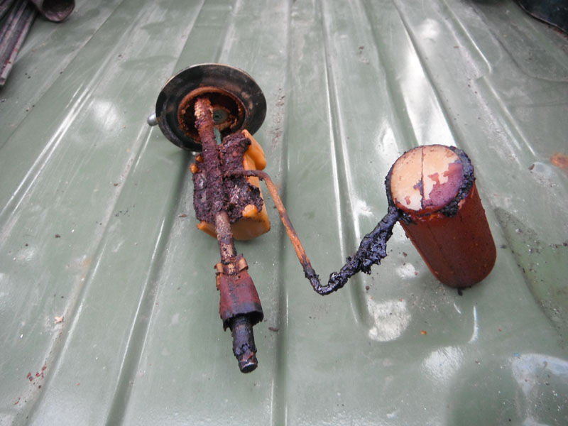

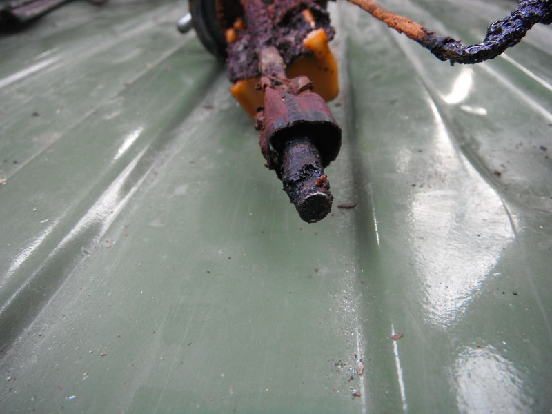

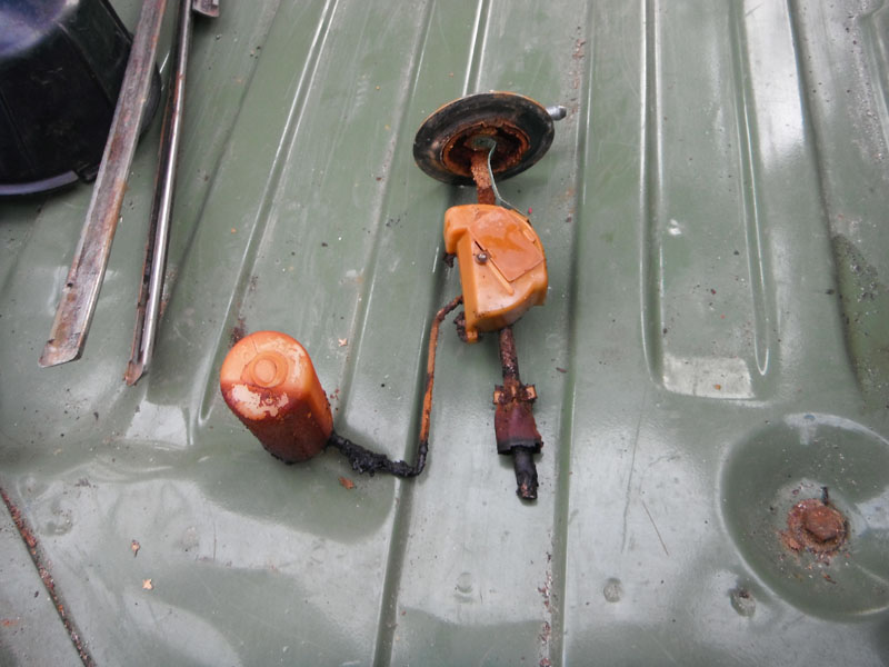

Another day, another failure to get the car running. Sorry to disappoint there. However, I do at least know what was causing the issue with fuel not getting where it should. Because absolutely nothing was coming out of the pipe I did what I should have done ages ago and pulled the pipe off the sender and removed it from the tank revealing immediately the problem which is a missing filter bag and a completely clogged pick up line as well as lot of sludge.
I know, I know, I should have dropped the tank and flushed it all through and checked this before even trying. I didn't, this is the result.

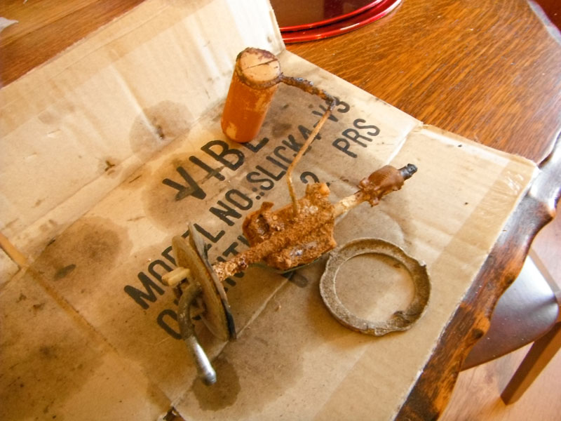

It didn't look like rust, so I let it all dry out before doing anything about it and it now looks like it's covered in what I assume to be refining sand.
I'll clean it up as best I can so at least it can be used to suck fuel up if not tell me how much is actually in the car. The fuel gauge has worked, once, while I've had this car so I'm hopeful this can be salvaged. It will of course need a new filter bag too since that's either dissolved or rolling around in the bottom of the fuel tank somewhere.

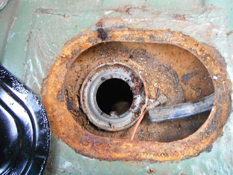

With the sender out, I checked that there is definitely fuel in the tank, which there is, you can just make out the reflection of it.

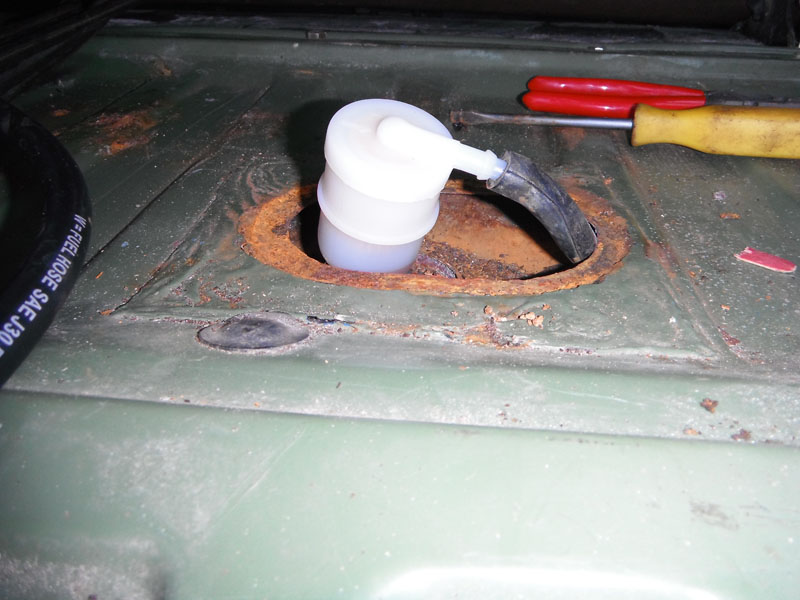

Bought a couple of fuel filters, the only ones the shop had, connected one to the fuel line and dropped a length of hose in the tank then connected the electric pump to the other end to see if it would pull fuel through.
Unfortunately, the fuel line that runs the length of the chassis has a blockage in it somewhere. Mike's going to bring the little compressor home so we can blow the line through back towards the tank to hopefully clear it and we'll retry a start with the current fuel filter set up. If the old sender does clean up and work then that's great, I'll get it refitted. If not, I'll look for a new one in the new year, I shan't have the funds for one before then.
I'm getting, at most, 3 hours play time a day on this car and that includes any errands Mike needs to run me on to pick things up. It's really frustrating as I'd like to get a lot more done in a day, there just isn't time with the short nights and no space in the garage if I had the car in there.
