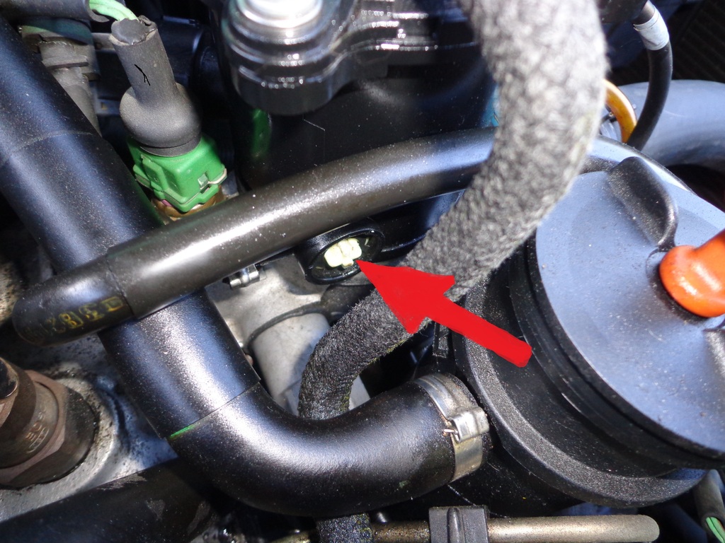

The manual said to drain the filter canister by undoing the drain screw and this is the only thing that looked like it but nothing came out the tube on the front . I finally worked out that the diesel is drained by undoing the fitting where the tube attaches to the housing. So have I upset anything by playing with the arrowed thing ?

Finally got my Photobucket to work, heres the thing I thought was the drain for the filter housing, I turned it a couple of times so would this have caused anything ? Again its on the lower right side of the filter housing.-

Yes, that white thing is NOT the drain, it is the end of the thermostat that directs fuel into a labyrinth in the coolant/thermostat housing below the filter to assist with warming the fuel in cold weather...
In your neck of the woods it won't be needed. If disturbed as you did then it'll now be potentially damaged, leaking air and maybe leaking fuel too.. They do give trouble and are a major cause of air leaks on these housings...
Air leaks will cause exactly your symptoms.
The proper filter drain is a black knob with a spigot to which a length of hose can be attached...
I'd initially try turning the white bit back to where you started just in case it is blocking/restricting fuel flow but ultimately you may have cased an air leak and the only good solution is cover the white ends and its surround with epoxy resin or similar to completely seal it. Getting anything to stick is tricky though due to the body being made of ABS and the diesel fuel being hard to effectively clean from the filter body...
I hope and pray the problem is just that the thermostat is now just in the wrong position and is restricting fuel flow. Those filter housings are getting hard to get hold of now...
Let us know how it goes and good luck!

I've actually sealed one of those housings at the thermostat with blu tack in an emergency. It was one of those repairs that got forgotten about and was still leak free 2 years later when I got rid of the car. Epoxy should work a treat if you have damaged it at all.

Looks like I may have upset the thing we are talking about, when I pump the primer bulb diesel leaks from it.CitroJim wrote:Yes, that white thing is NOT the drain, it is the end of the thermostat that directs fuel into a labyrinth in the coolant/thermostat housing below the filter to assist with warming the fuel in cold weather...

That'll be it thenkiwifrog wrote: Looks like I may have upset the thing we are talking about, when I pump the primer bulb diesel leaks from it.
The fix for that is above... Try James's Blu Tak trick first

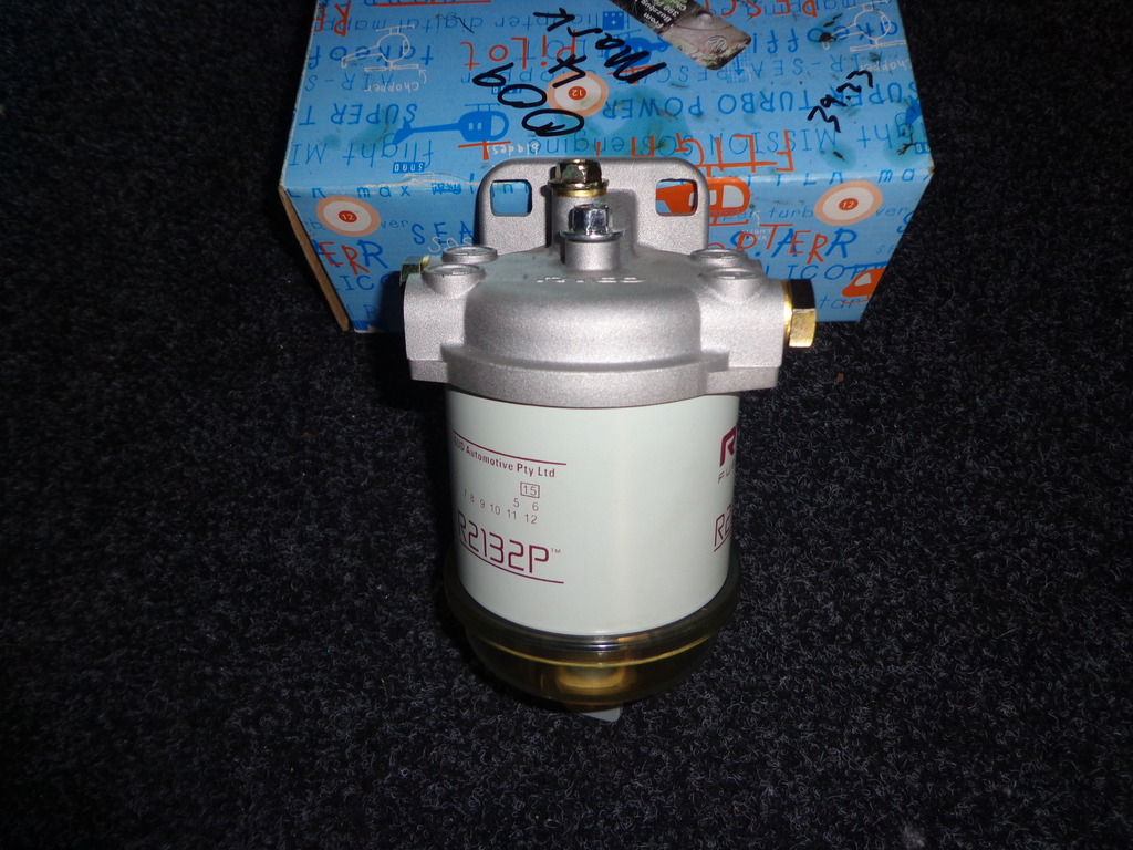

I have one of these for another project, what are your thoughts of bypassing the factory canister and plumbing this in ? I know it wont be heated but its dosnt get that cold here. I noticed theres a sensor on the factory canister, is that for temp ?

That would be perfect and a worthy successor to the original. Absolutely perfectkiwifrog wrote:
Main thing is you always have a proper diesel filter in circuit. Running without will soon cause damage to the pump...

My personal preference if it were my car would be to fix the one in the car. I've had a very similar filter to that on an Xud and it runs less smoothly without the heating.
