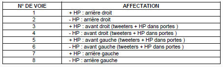

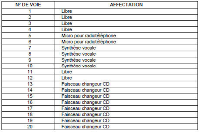

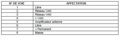

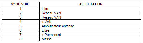

So as long as you have this pre-equipment installed and have coded it to your car, it should work - I've translated it, so may be of use as a checklist / info.
PRESENTATION
The vehicle can receive three types of radios:
radio cassette mechanics: RB2,
compact disc radio: RD2,
radio: RT2.
variants:
with or without power amplifier (HiFi) for RD2 and RT2.
The vehicles have the following series of pre-equipment:
pre-wired speakers and tweeters,
pre-wiring the car radio,
cabling antenna feed,
impedance housing,
a short amplified antenna.
The series radios are associated with a removable drive under the steering wheel switch module.
CHARACTERISTICS
Car radios (RB2, RD2 and RT2) are protected by a code corresponding to the last 8 digits of the VIN (Vehicle Identification Number). A setting of + APC, the BSI verifies its pairing with the car radio. If it does not, it switches scrambled mode.
The radio telephone RT2 provides the functionality of a GSM mobile phone combined with a hands-free kit:
sending and receiving calls with automatic disconnection of the active audio source when taking calls,
display of telephony features on the integrated LCD screen radiotelephone
acquiring the voice of the user by a specific microphone in the base of the dome,
restitution of the speaker's voice through the speakers of the vehicle,
management of SMS messages (TV spots)
Emergency call,
compatibility with a remote handset.
The information display on car radios was deported to the multifunction display.
Speakers Features:
dash: 2 tweeters,
front doors: 2 speakers (boomers, diameter 165 mm)
Rear Doors: 2 speakers (boomers, 165mm diameter).
HiFi variant is equipped with:
dash: 2 medium / tweeters,
front doors: 2 speakers (woofers, 165 mm diameter)
Rear Doors: 2 speakers (woofers, 165 mm diameter) and 2 tweeters,
Safety: 4 x 20W amplifier 1,
under front seat: Compact disc changer multiplex.
Input connector (8-way black) Connector outputs (white 8-way) Connector interface compact discs 20 tracks All vehicles equipped with a series of radio (RB2, RD2) have the following pre-handsfree equipment:
Hands-Free Pre-equipment:
a specific GSM antenna integrated radio function,
an aerial cable (coaxial) specific radio / GSM,
power cables (power supply, micro cable)
a radio link (MUTE + HP).
Note: The handsfree kit is offered in Accessoirie. The hands-free kit contains a bracket to attach to the side of the central facade.
