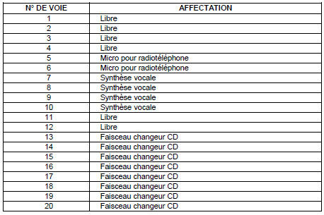

Two days ago I finally found the diagrams I needed. Citroen was of no use. Now I have to make the connections by myself. And I'll to it!
But, there is a little question if anybody could answer. I can't use the phone mode on the RT2 (Clarion JE-3002U(I)). If there is no SIM in it, it display the message "No SIM". When I insert the SIM, the RT2 recognizes it, but after a few seconds it displays "Rech. GSM" and nothing happens. I cannot access any commands for the phone mode. Can anyone help me, please? What is wrong?

So as long as you have this pre-equipment installed and have coded it to your car, it should work - I've translated it, so may be of use as a checklist / info.

Input connector (8-way black) Connector outputs (white 8-way) Connector interface compact discs 20 tracks All vehicles equipped with a series of radio (RB2, RD2) have the following pre-handsfree equipment:

So, everything is right. I previously had a RB2 radio-cassette-CD player with a Compact disc changer multiplex. All the pre-equipments are in place. I made the connections, and the service paired the RT2 with my car. The radio and the CDs are working fine, but the GSM phone doesn't work at all. I asked the service about this, but they are not very interested because the car and the RT2 are pretty old and time consuming for them. That is why I have to do it by myself. The following days I have to connect the Siemens navigation system CEM1. I hope at least this will work. But what about the GSM inbuilt phone?
