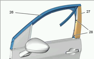

Ok, so if it is Part 11, the part numbers are:
9326 AT for the left hand side
9327 A4 for the right hand side
These are £49.64 plus VAT each, so £59.57 inc. VAT from Citroen.
If it any other part let me know. These trim parts are held in place by rivets and the side part of the side frame seal needs to be dislodged carefully to access these as shown below - so if you could find these from a breaker's yard, you'd still have to drill out the rivets to remove them.
