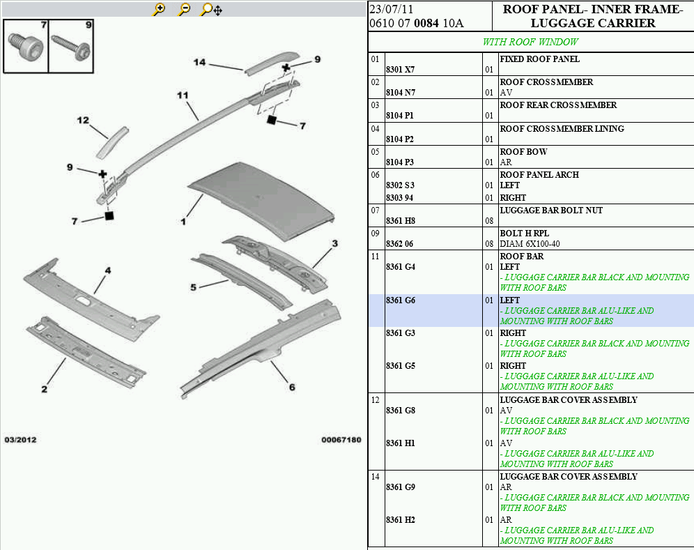

Welcome to the Forum and sorry to hear about the damage, I would be gutted too.
There are a couple of possible options, as I believe the rail bars are sold as component parts and I don't think they sell the paint for them as they are made for Citroen.
The roof rail parts are available separately, including the trim covers and fixings according to Citroen service. The cost of one bar (left or right) is £68.98 inc. VAT for the Aluminium one and £54.47 for the black one, with the corner cover trim another £17.57 - £26.78 depending on colour. There are other parts available, depending on what is damaged that I can look up if needed.
Do you have comprehensive insurance and protected no claims cover, with a reasonable policy excess? Seeing as the door panel has been damaged too, it might be worth weighing up the cost of making a claim to have the paintwork professionally restored and the roof bar replaced.
Another option for the roof bar is to go to a body shop, they may be able to match the paint for you, and give you a quote to repair the lacquer coat on the door panel.
For the price of either the trim or the roof bar - it may be more cost effective and less hassle to replace the parts than try and match the paint - especially as the roof rails will have to be rubbed down and prepared for the paint to stick - as I believe they have a finish on them - which will add to the cost and time considerably in preparation. I've gone through this route on my internal door plastic trims where the paint was so thin and not finished properly it flaked off in parts. It took 3 days, 2 attempts at rubbing down to the bare plastic, priming several coats, painting with the custom paint, lacquering - ended up costing me £40+ for the paint, primer and lacquer, but the trims where £30 each new x 4 - so I was happy to do this as a project and it's now better than the originals!
Anyway - here is the diagram, so you can check which parts you should be able to replace (this is for a generic Tourer, with glass roof, but if you post up your VIN, I'll be able to confirm the exact part numbers for your car and year).

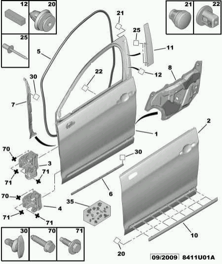

Ok, so if it is Part 11, the part numbers are:
9326 AT for the left hand side
9327 A4 for the right hand side
These are £49.64 plus VAT each, so £59.57 inc. VAT from Citroen.

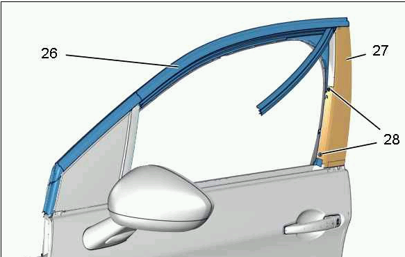

If it any other part let me know. These trim parts are held in place by rivets and the side part of the side frame seal needs to be dislodged carefully to access these as shown below - so if you could find these from a breaker's yard, you'd still have to drill out the rivets to remove them.
