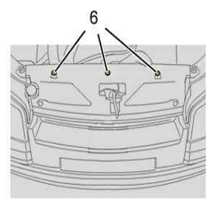

Remove: The screws (3) and (4);
the protection deflectors (1) and (2)
Remove bolts (5) each side.
Remove the bolts (6).Unclip the bumper at " a". Remove the front bumper.
Disconnect the electrical harness.
Refitting
Proceed in the reverse order to removal.

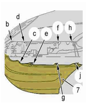

Engage the cut-outs " c", "e" and "g" onto the tongues "b", "d" and "f" of the front bumper (7)
and the pin "j" in the hole "h" of the front wing.

The diagrams seem to cover front bumper removal and replacement but not the adjustment necessary to try and cure your misalignment problem.
With the bumper removed and roughly in line with the left and right hand edges of the bonnet you will see two brackets which support the front of the bumper and can be adjusted with the usual 10 mil nut.
There is a black plastic moulding behind the bumper held with an array of self tapping screws and it is this that sits on the adjustable brackets. It is possible that if there has been a coming together involving the front of the car, that this moulding has been deformed. If so you need to decide on a wire/glue repair or replacement.
I have found that setting these brackets needs to be an interference fit when removing or replacing the bumper to give the correct alignment with the wings and windscreen washers if fitted.
I can only suggest trial and error to get the alignment as you want and it can be a pain because the bumper has to be lifted in and out of place until you get it right.
Good luck, hope that helps.
