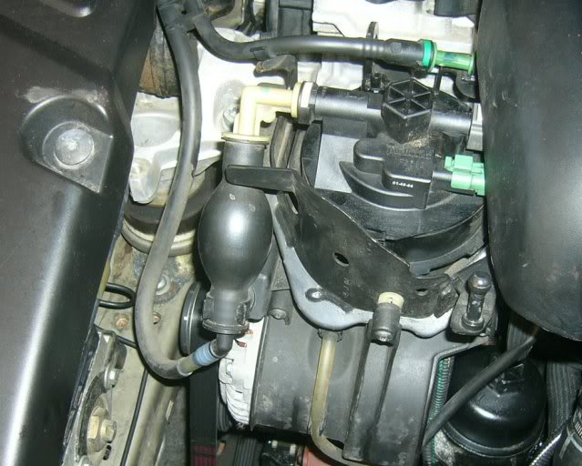

Is it like this one? If so remove the fuel pipes by pressing down on the white tabs. Also the connector. Use a close fitting socket to unscrew the lid and use a new rubber ring.

Yip that's the one
