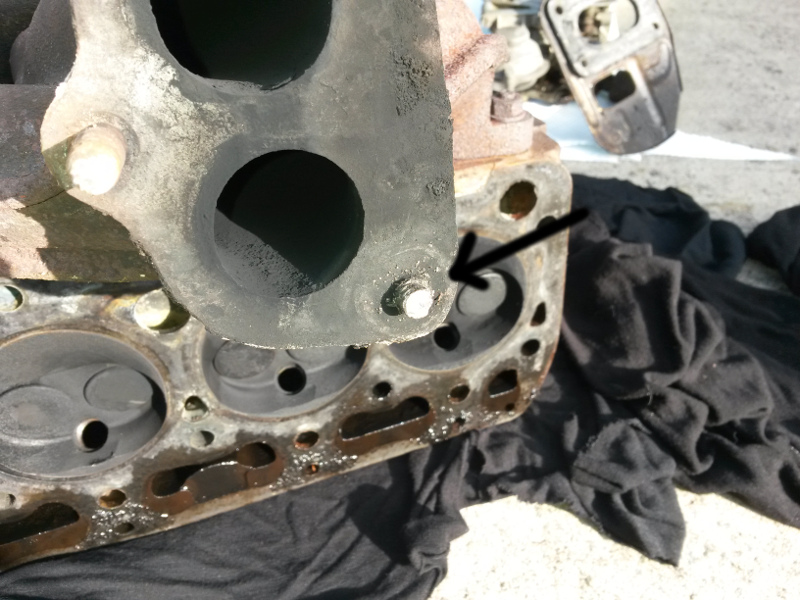

Presume the stud is in the manifold? Is there any sticking out? If so you might get it with a pair of mole grips or stilsons, or an Irwin bolt extractor. If nothing sticking out, then you could try welding a nut to it through the centre of the nut. The heat from the welding will help to free it - and you can soak it in plus gas before you start to help with the chance of getting it out. Drilling it out possible, but you need to be accurate as the manifold is probably a lot softer than the stud! If there's an engineering shop near you, they might be able to spark erode it.

This little blighter is the exhaust manifold to silencer stud that has snapped. It's in the manifold, and I don't think drilling it out is an option as even if I took the manifold off, the centre branch is in the way I think so there's no access. I'm not too worried to be honest if the hole remains perfectly round as there isn't a stud going back in there. These things break exhaust studs for a passtime, so once that stud is out it's getting replaced with a stainless steel nut and bolt so I don't have this problem again a year down the line when the exhaust needs changing!

That stud'll come out - an Irwin bolt grip will get it if you give the manifold plenty of heat. Otherwise weld an oversize nut on it and my guess is it will just wind out.

Interesting. A tool I will need to investigate in the morning!
Always a bit nervous of using a lot of heat on manifolds in localised areas in case I crack them - especially these ones which are known for cracking easily.
