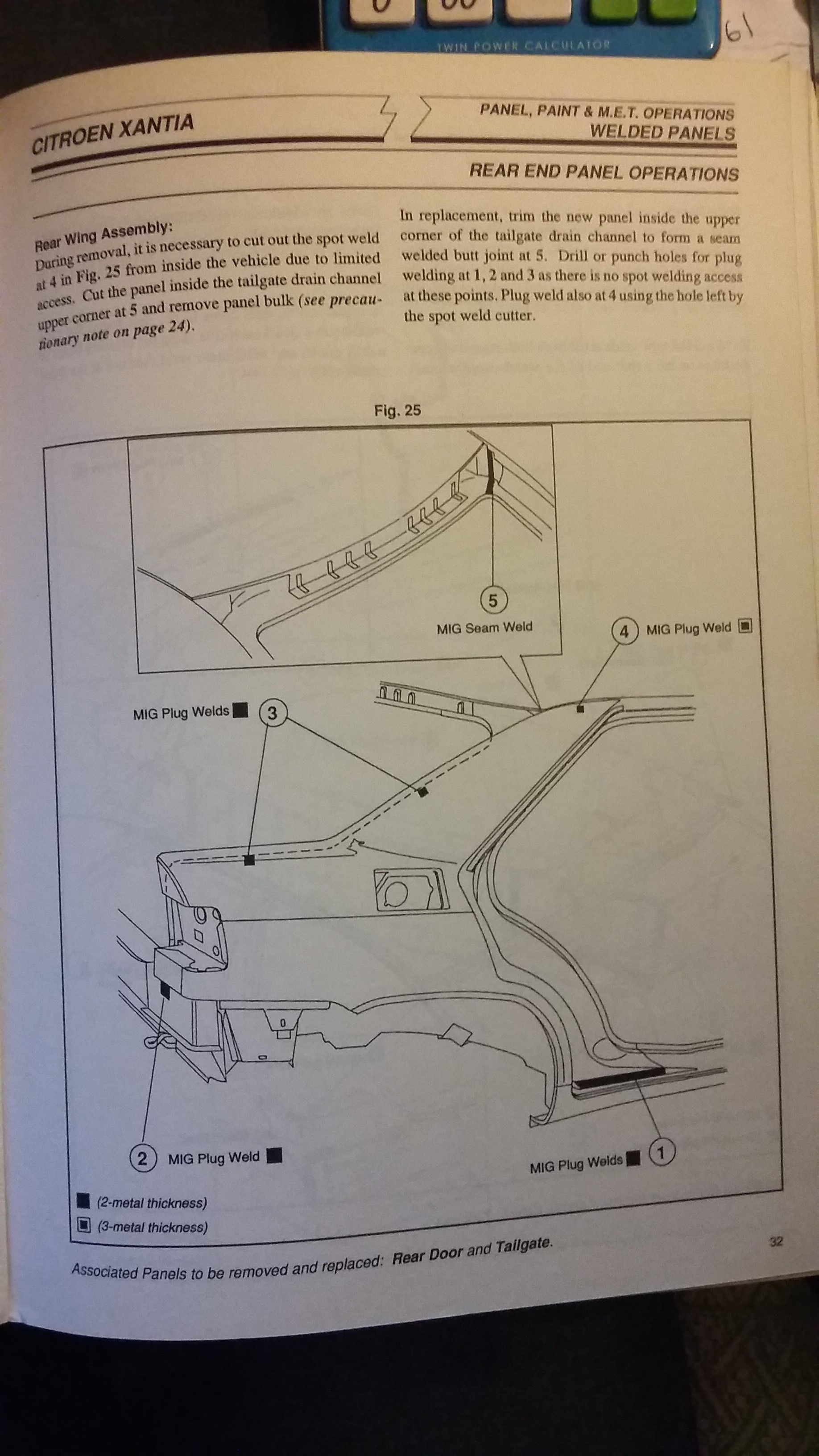

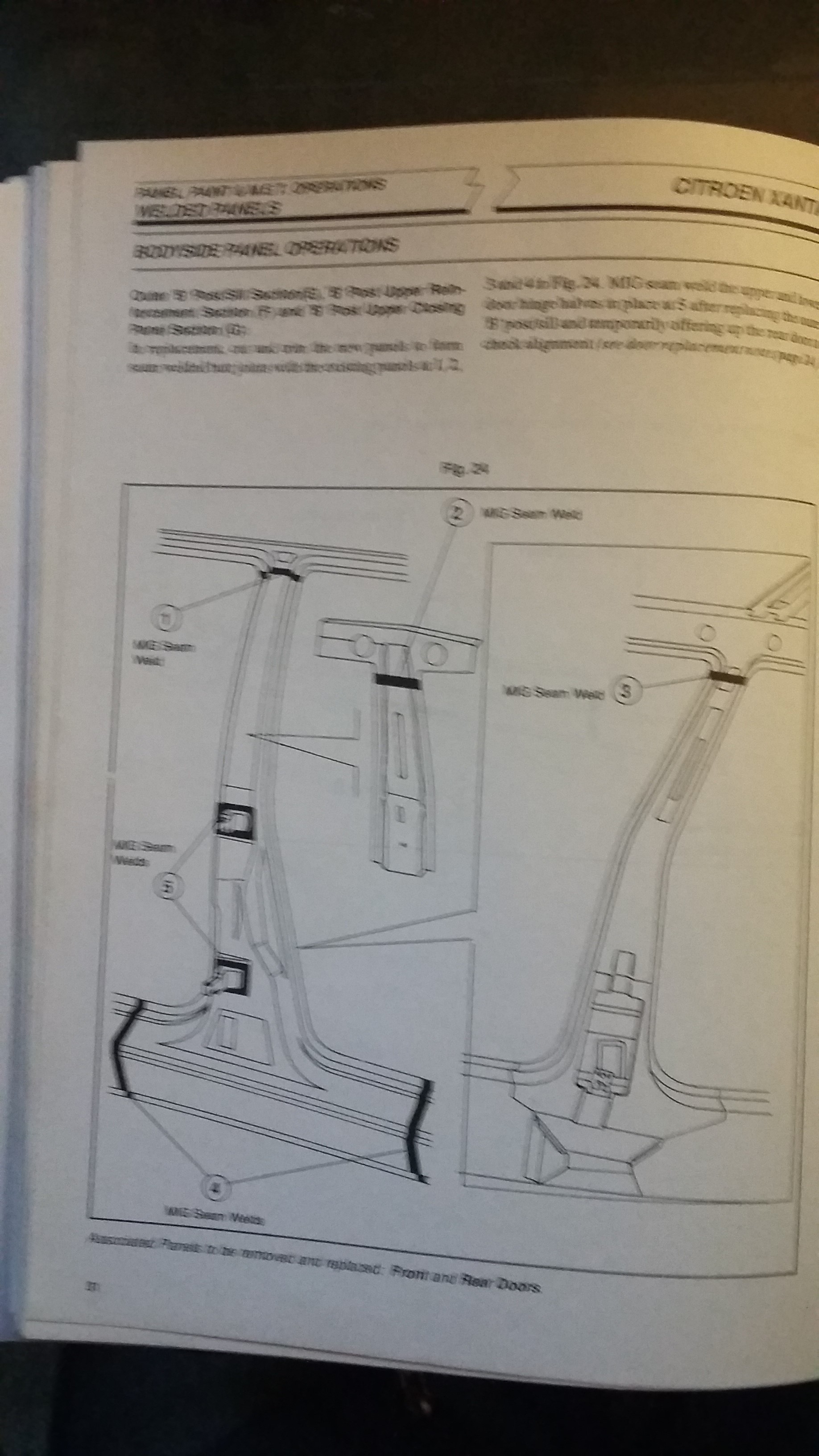

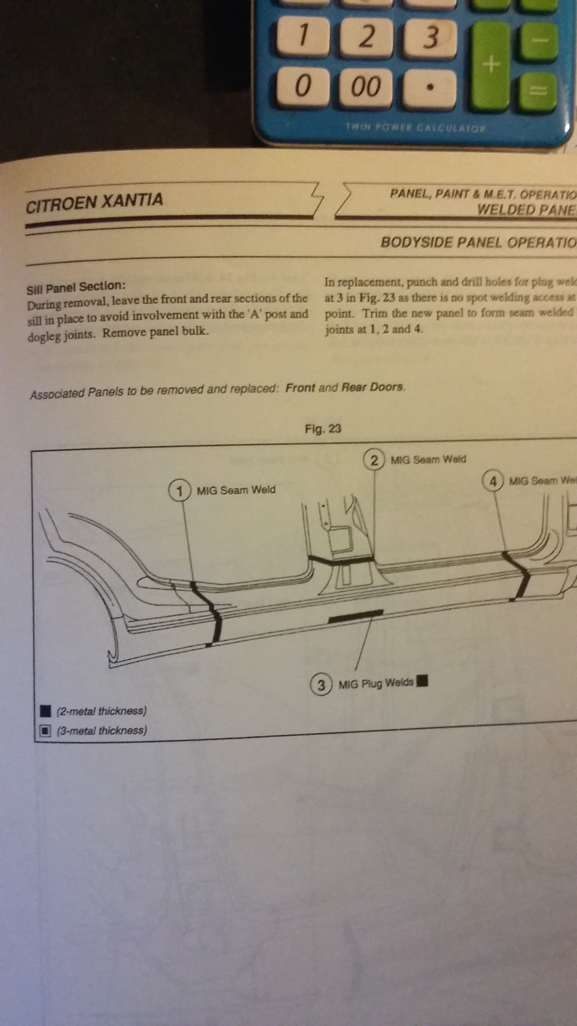

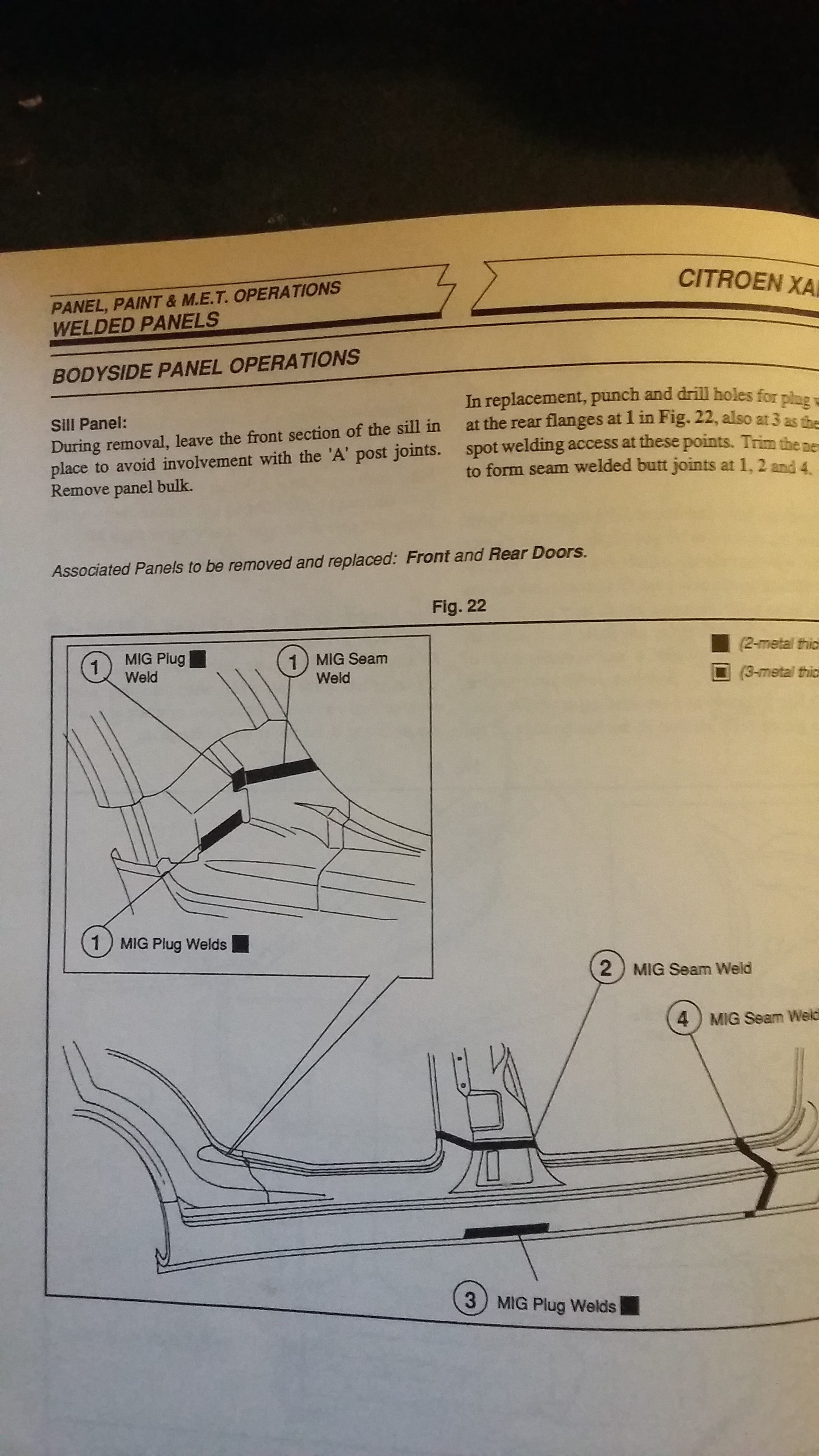

These may help, from the THATCHAM repair procedure book. the welding should follow as described.

Thanks. My printer is kaput lol. I'll print these off at my daughter's and give them to the guy, see if it guides him any. I really hope there's no more underneath

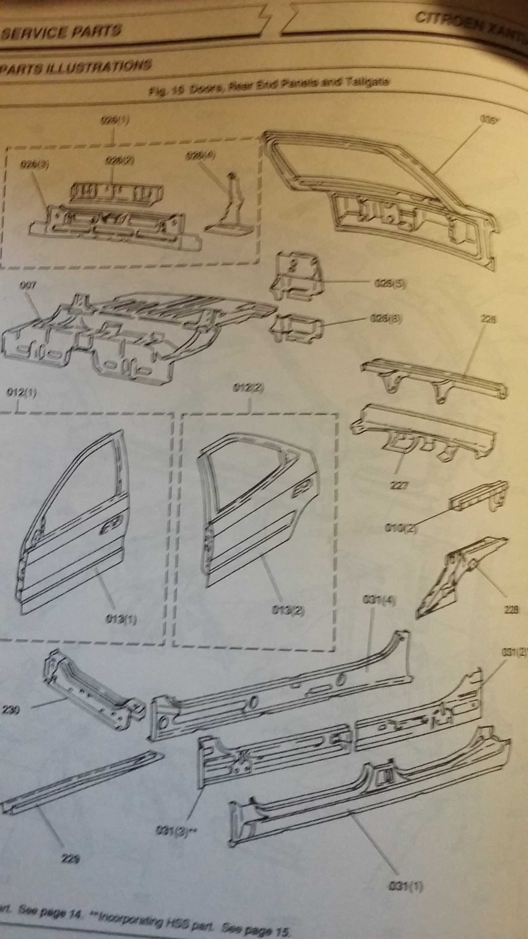

Re: Xantia sills.
All listed as available except the rear section of the RH middle section (there's inner, middle and outer sections; the middle section is in 2 parts) 73 and 74 are the front sections (left / right) , 75 and 76 the rear (left / right). Same parts MK1 and MK2.
