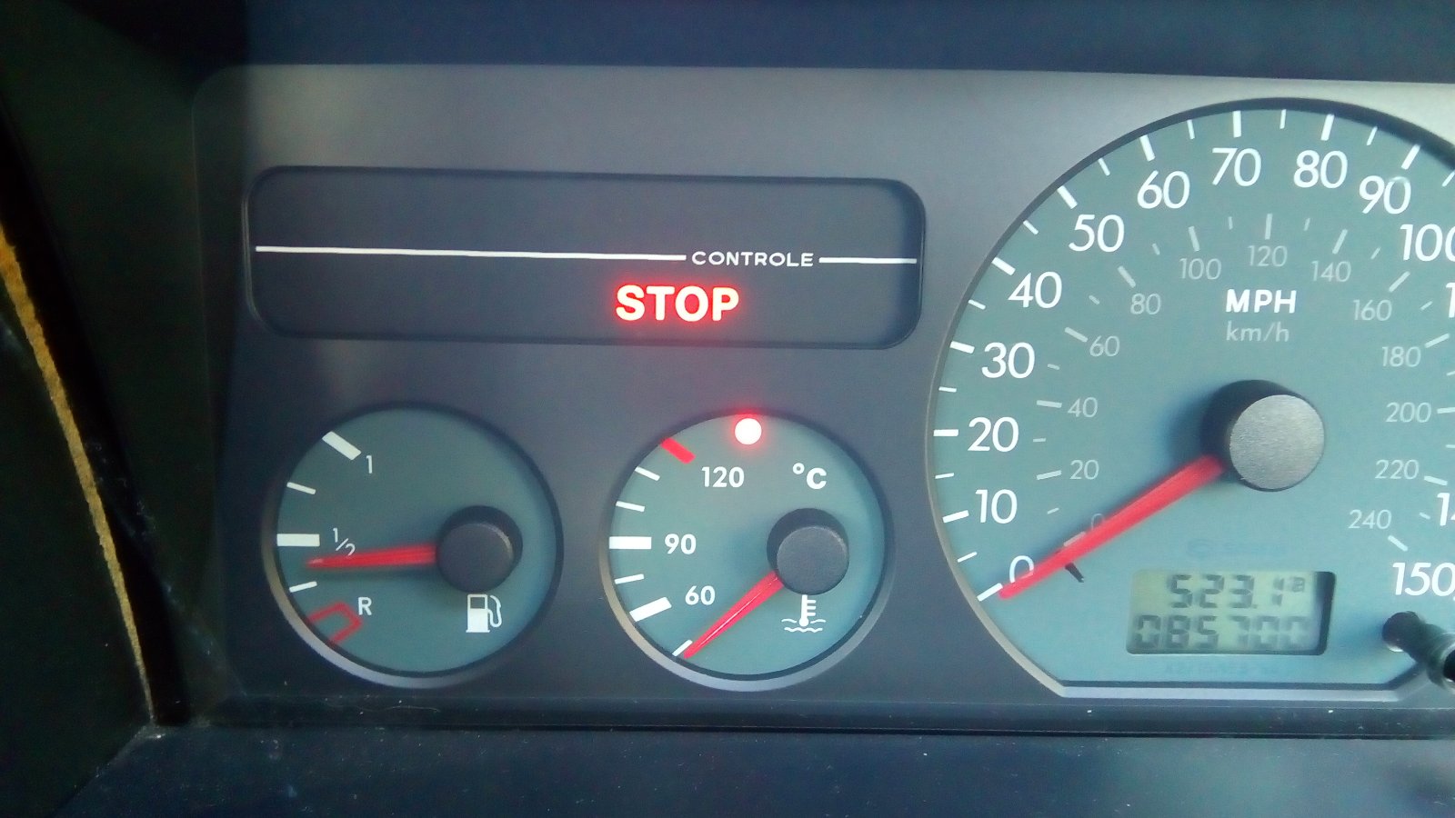

Well, after over a year of trouble-free motoring, I encountered a problem today.
I was greeted with this when I started it. This was taken with the engine running:

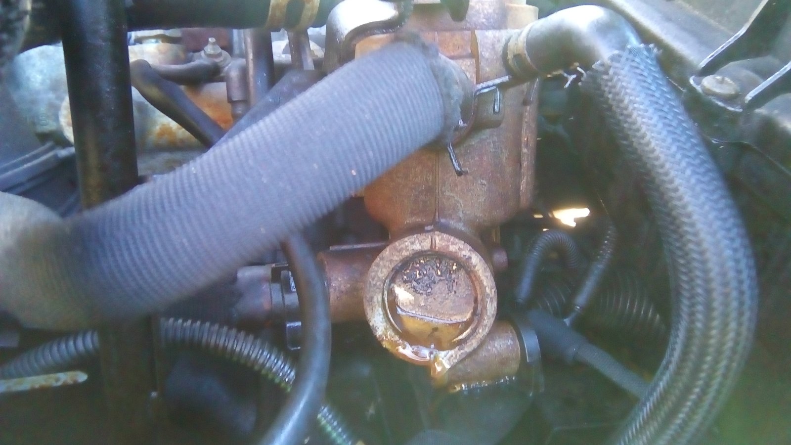

I looked a bit closer...

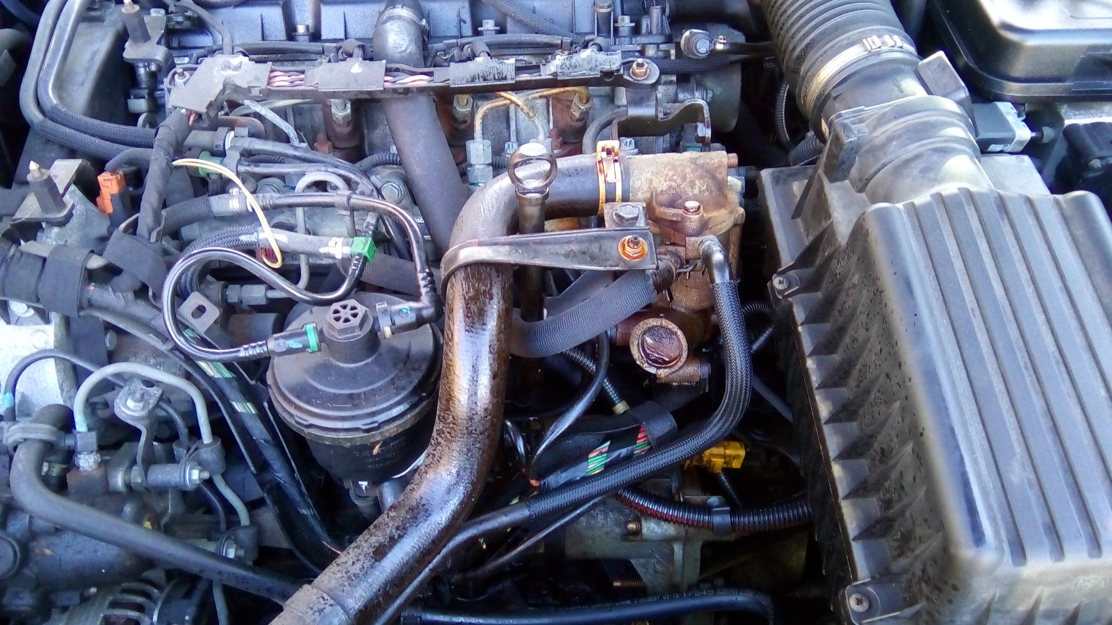

So, what seems to be happening is that coolant is leaking out of a pinhole to the left edge of that indented circle below the thermostat housing. Liquid metal time, or is it a telltale to let me know the thermostat needs replaced? Help me out here.
I topped up the coolant level and it seems happy enough for now, but when up to temperature there's a fine spray coming out of the pinhole, covering the top hose and the inside of the radiator in sticky coolant residue!
It's a 2.0 HDi 8v 90hp, by the way.
EDIT: It seems to be a core plug. I've ordered a replacement already. This could be fun!
Posts: 55111
x 8403
Re: My Xantia HDi Shed
Core plugs are easy enough to replace... Pull the old one out by screwing a meaty self-tapping screw into it and then use a claw-hammer or forked pry-bar to pull it out..
Clean up and carefully tap the new one home evenly and gently with a small hammer above a hard wooden pad...
