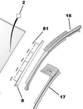

The part numbers are:
For the trim itself (part: 8120 Y8) @ £82.38 inc. VAT
For each Clip (part: 8110 25) @ 0.61p each inc. VAT and you will need 5 of these
So in total £71.20 Ex VAT (£85.43 Inc. VAT)
However, this part will require painting to your car - so add on whatever a body shop will charge you unless you're feeling brave and fancy getting the primer, paint & lacquer made up - so it's probably cheaper and easier to get it done for you.
The last option is to try and track a trim down from the breakers in your colour (they simply unclip off and on - and just buy a new set of trim clips from Citroen for £3

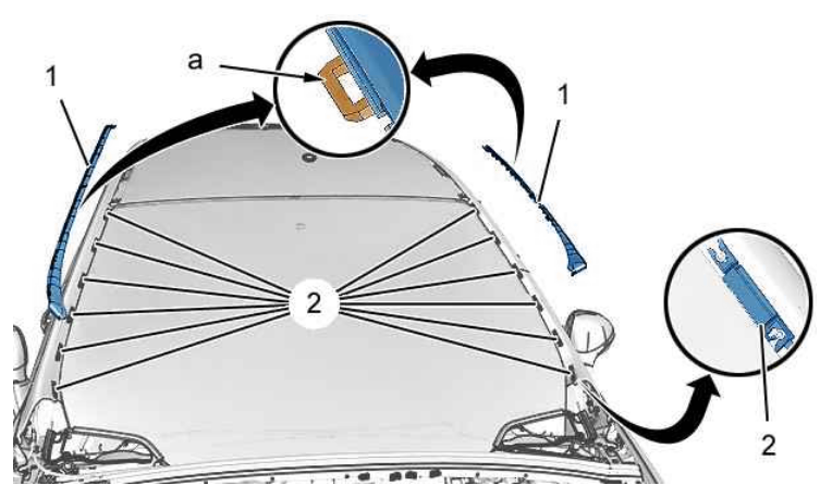

chaps mine has been flapping for a year.. very annoying! I bought some new clips and they arrived this am.. until now I have been using white duct tape, which worked ok..
I have stuck the trim to the black undertrim, and will try and fit as a pair now, wish me luck! presumably I can fit the 5 yellow clips, then slide the rest into those?
J
J
- GiveMeABreak
- Posts: 37339
- Location: West Wales
C5 MK I 2.0 HDi SX Wicked Red
C15 Romahome White
XM 2.0 SX Polar White
CX 20 Polar White
GS 1220 Geranium Red
GS 1000 Cedreat Yellow - x 5723
Re: 2009 C5 Windscreen trim

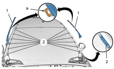

Here's some info John in case it helps:
Unclip the tabs at "a" of the clips (2) starting at the bottom and detach towards the outside ; Using tool [1].
Remove : The windscreen aperture pillar trims (1).
all done Marc thanks
so, the two star washers that held the steel trim to the undertrim, one had become detached.. hence the flapping of the trim.. I took outer and under trims off (earlier in week), re-attached the white upper trim and reused the star washers, compressed them on.. I also bonded that part to lower trim with siko,
now I just added the five clips, offered the whole panel up, clickety-click
I noticed that the lower windscreen scuttle had become raised and set that back down again..
phew, nice job! 1 year of misery, and £4 to sort!!
