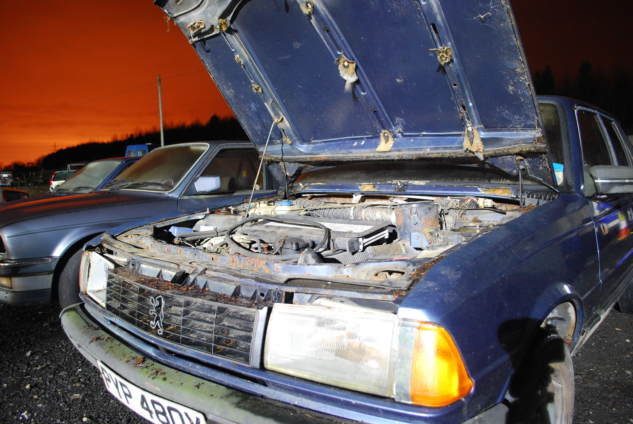

My 305 SRD
ImageApplecross in a 305 by srblythe, on Flickr

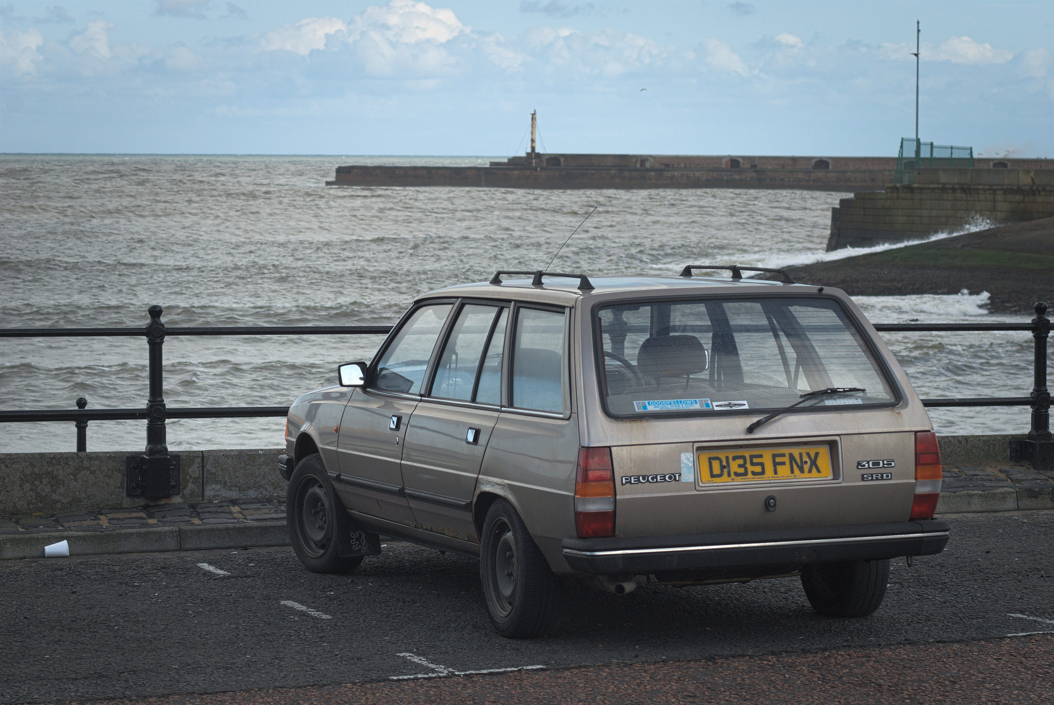

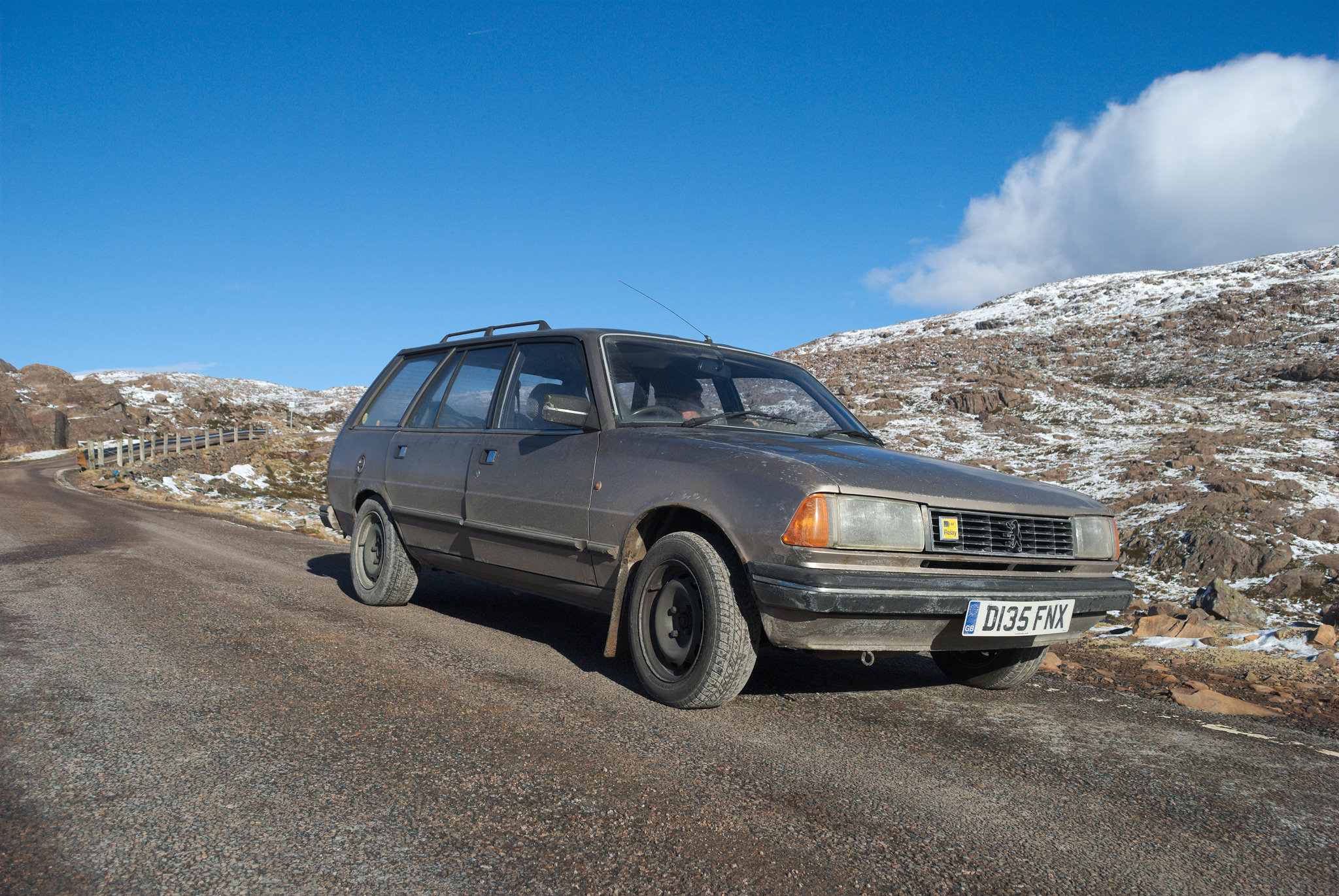

My other 305 SR is fitted with an xud turbo from a 306, I bought it like this so know nothing about fitting xud's from one car into another.
ImageDSC_9506 by srblythe, on Flickr
ImageDSC_7651 by srblythe, on Flickr

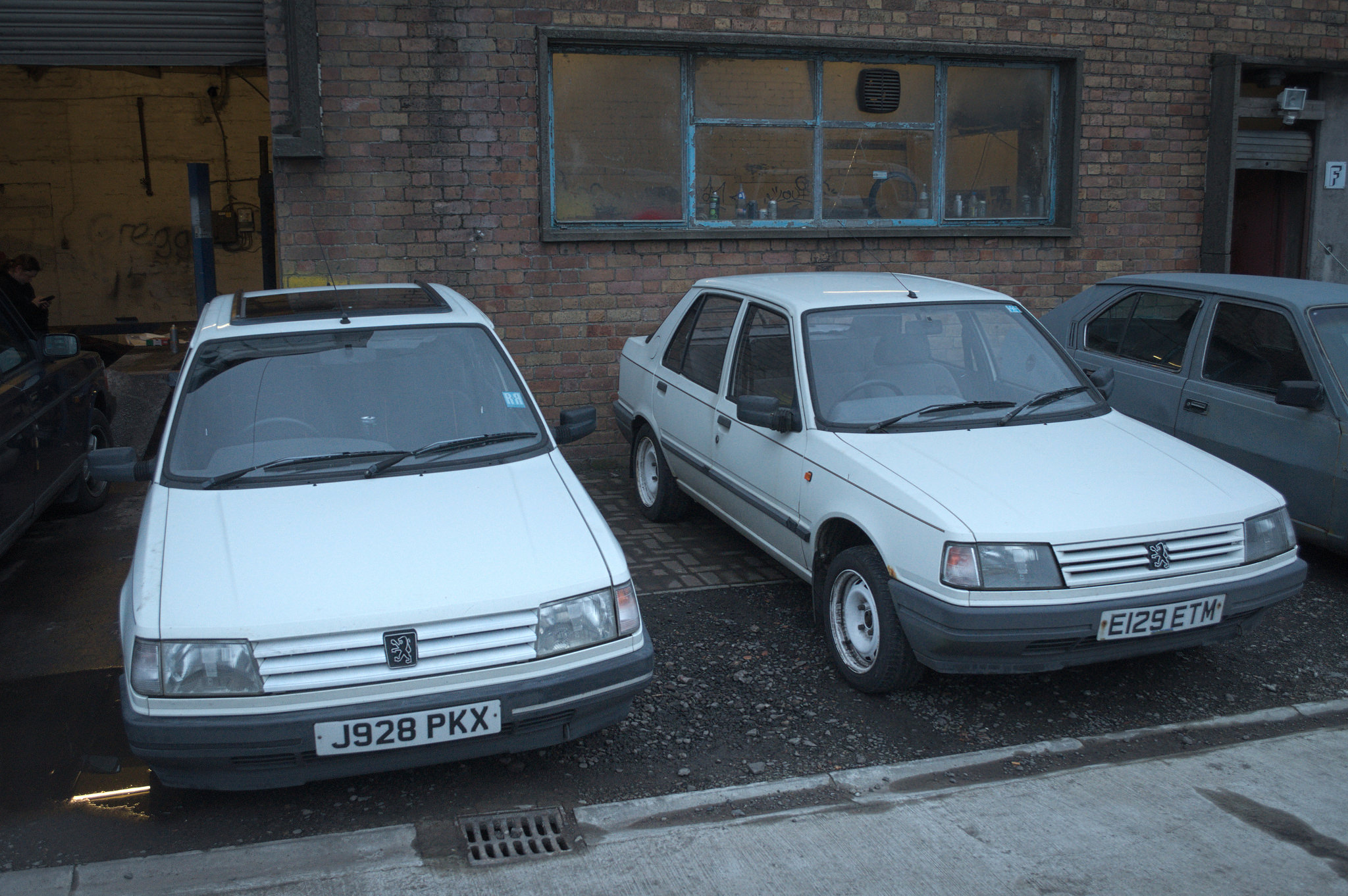

I also had a pair of diesel 309's
ImageDSC_0106 by srblythe, on Flickr

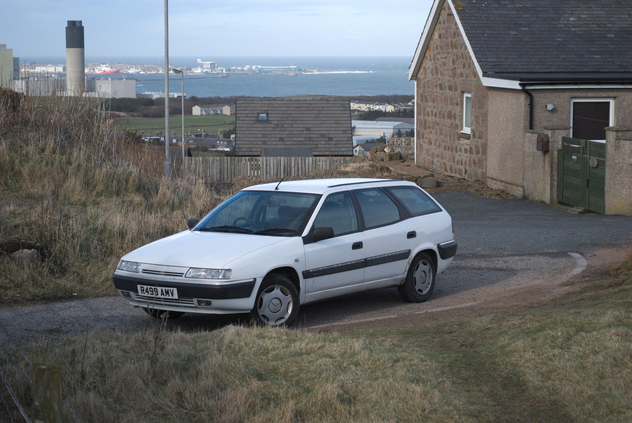

Enough about that, what I'd like to know is how easy is it to fit the xud turbo engine from this
ImageCitroen Xantia Peterhead by srblythe, on Flickr

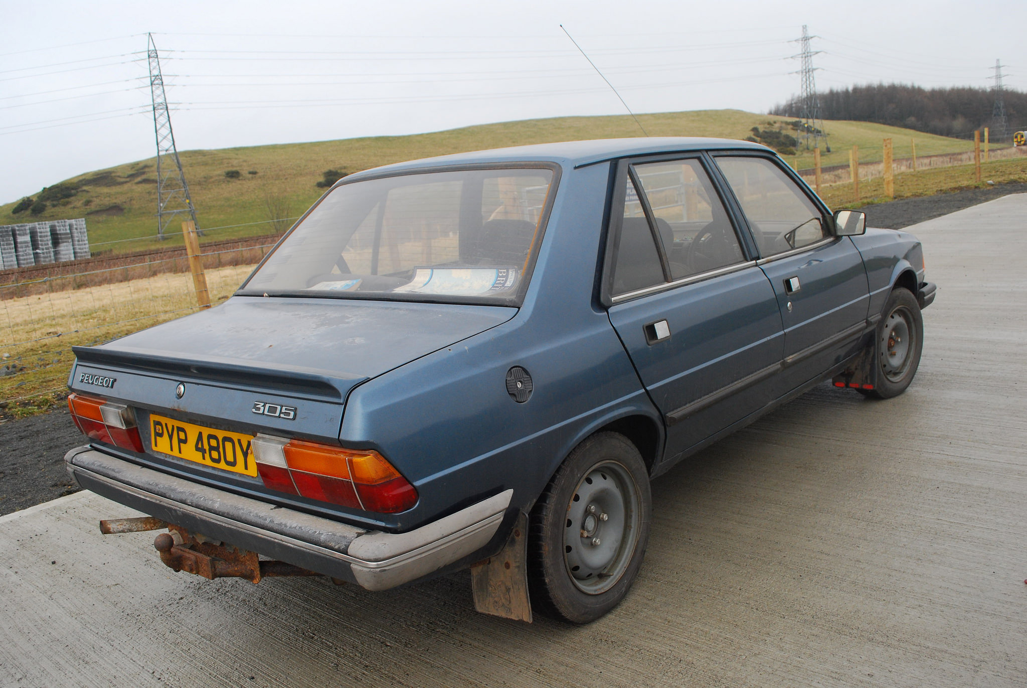

into this
ImageDSC_9326 by srblythe, on Flickr

The vacuum pump is probably the problem. Thee are two types. One is belt driven from the wrong end of the camshaft as on the 305 and earlier 405 etc.
The other type is driven directly by the camshaft and is bolted directly to the head.
The BX has the pulley at the gearbox end of the camshaft for driving the hydraulic pump. The Xantia uses the accessory belt to drive the hydraulic pump. I don't know if it's possible to fit a vacuum pump.

The swap would be ok.. Shame to kill a xantia though scott.. You can go two ways.. The xantia p reg will have an end on cam vaccum pump so its there already for you..
You can also possibly with a bit of fettleing fit the 305 xud cam in the engine and remove the end cap on the xantia head which is a bolted cap.. And fit the gearbox mounted pump..
The engine the 305 sbould have always have had.. There might be an issue with the inlet though.. The xantias is quite high up with front mounted intercooler but the 306/405 / BX inlet will simply fit onto the engine.. Everything will be bolt changeable scott.. Not a hard job at all!!
