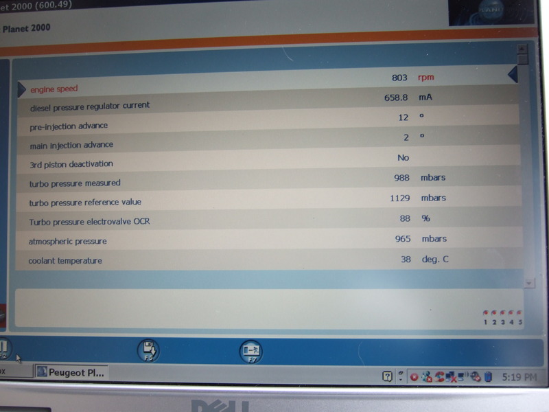

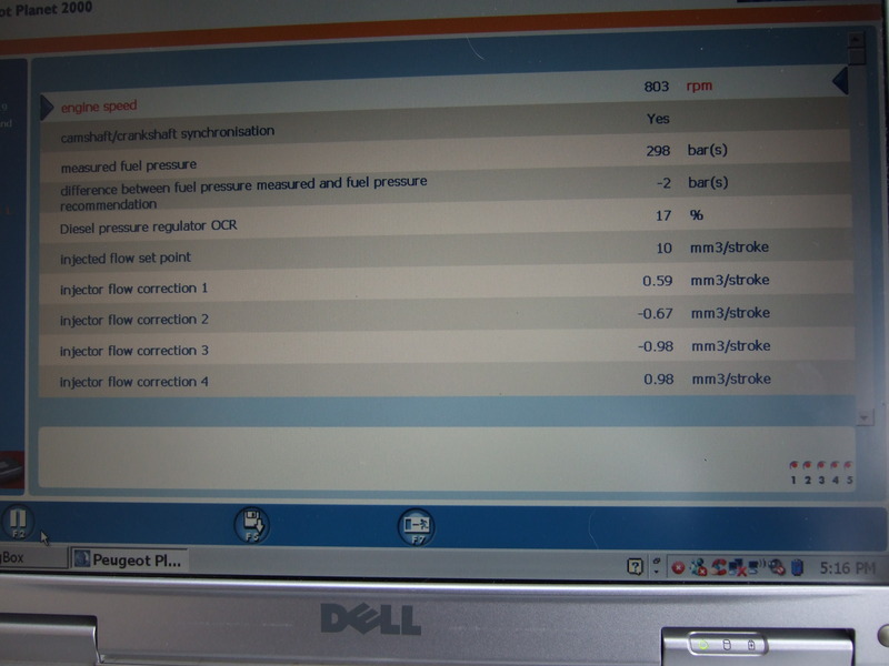

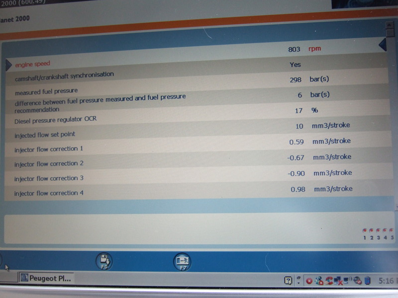

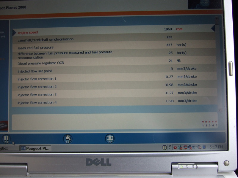

They are photo's of my PP2000 screen on the 406 which is using about twice as much fuel as it should be, I am hoping someone can tell me if there are any anomalys.

Can anyone make any sense of these? I was hoping it was something as simple as the timing being one tooth out but it says 'camshaft/crankshaft synchronization - yes' Can I assume that means its timed correctly?
Is there anything that doesn't look right on there?

That data doesn't look too bad. Inj 4 looks a bit suspect - does it ever move off 0.98? I wonder if the EGR valve might be stuck open - but you can't see the position on this engine. What does the air flow say? If you unplug the EGR valve (electric or vac to the solenoid) does the air flow jump up? Although it says timing it OK - mine certainly ran better and was more flexible after I changed the belt.

I will check that injector again although it runs sweet as a nut and ticks over smoothly, if fact its been very well looked after, the exhaust doesn't smell right when its cold sort of acrid smell like a petrol engine. Didn't find any airflow data, probably not looking in the right place. I have replaced the MAF and fitted a new thermostat all to no avail.
I have disconnected the vacuum supply to the EGR and that doesn't seem to have made any difference either, it appears to be closing OK as the exhaust feed pipe is not getting hot.
The only thing that does puzzle me is the presence of a butterfly valve in the pipe from the intercooler to the engine, what does it do? If it isn't opening when it should that would be restricting the air supply.
As I say the car drives fine, no smoke that I can see and very quiet - like retarded timing on an IDI, the performance is down a little but not a lot. I have taken to using my C5 which is usually a spare car now as that is averaging around 50 mpg, the 406 is down to about 32 mpg! on the same journeys. My old 406 would do 60 mpg+ on any long journey.
