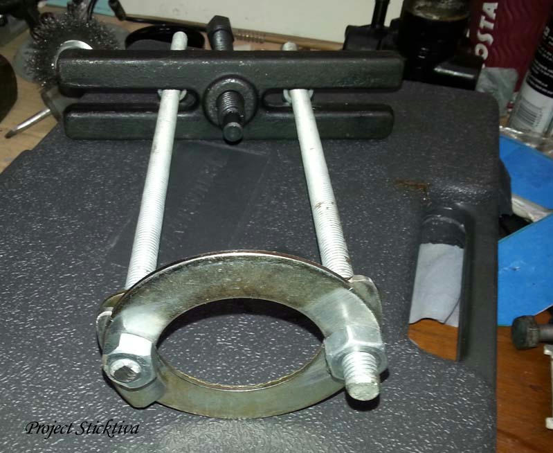

Ye they can be repaired....(Most) often it is the leak back seals that are the problem.
Jim .....over to you (Jims links) http://www.eastment.net/ramrep/index.htm
the start of my story http://www.frenchcarforum.co.uk/forum/v ... &start=255
The tool I made for the removal of the scraper....you can borrow this if you need to....easy to make with the correct size washers and threaded rod however
http://www.mediafire.com/convkey/8a48/c ... sibfzg.jpg

There's a trick with the front as the XM repair gaiter is a little large and needs to be packed out to ensure a good seal at the top. Also, the lathe work to make a clean sealing surface is vital to the success of this repair.DS21 wrote:Thanks for the link, my Citroen garage have already performed this modification but it doesn't seem to have done the trick in my case.
