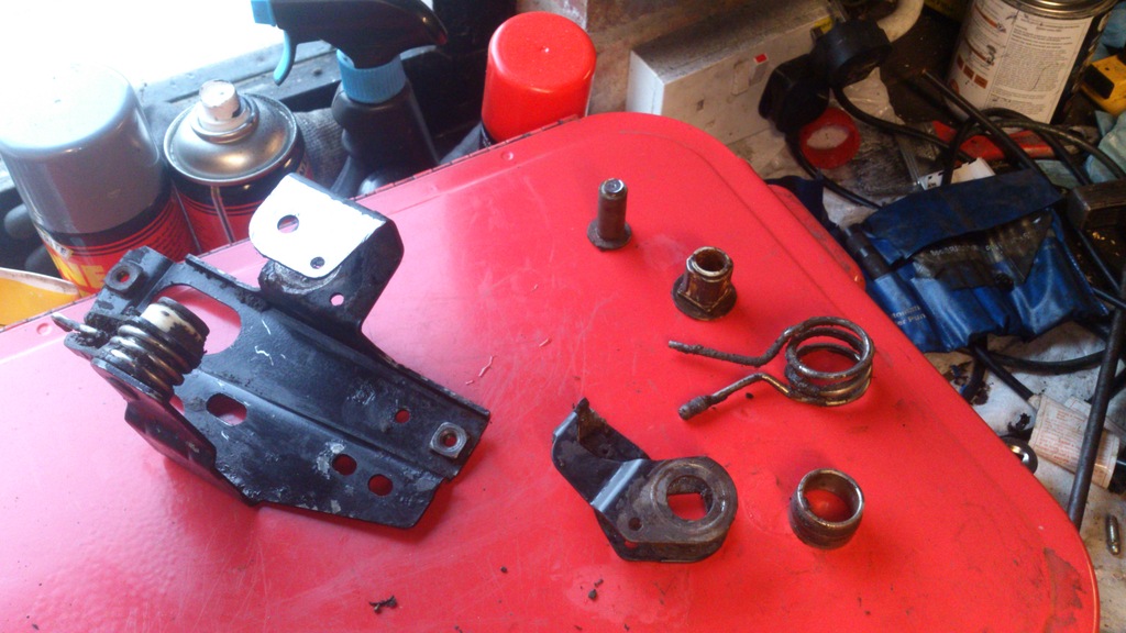

Thanks to citroenxm for supplying a pair of Xantia height correctors. My plan was to make a modification to the notorious pivots. I was inspired by the pictures in the past of the pivot pins removed and replaced with new machine screws. Neither of the correctors on the car have seized pivots but they do have a lot of free play in the pivot.
I like the design of the Xantia height corrector cradles. The point of the design is that the action of the anti roll bar is stepped-up to the height corrector due to the use of the lever that the plastic dog leg moves, around 1:2 ratio since the dogleg acts on the half way point of the lever. It means the self- leveling on the Xantia can be more accurate and sensitive than previous models where the actuation was nearer 1:1, since it only needs half as much input from the anti roll bar to give force to the HC valve. The spring in the lever has a much larger range than the older designs (all previous HC linkages have a springing aspect to allow many movements of the suspension not to over activate the HC valves)
But! the Xantia units can seize as we all know! This isn't the problem though - the other issue is that the main pivot is made of nothing more than a plastic bush moving around the metal pin. Thing is the plastic bush wears terribly and gets loads of slop to the movements of the dogbone so that the smaller movements such as one driver stepping out the car, goes to moving the looseness of the plastic pivot bush instead. It ends up acting worse than the older designs when this part wears. (it's aggravated also by the fact that the plastic dogbone thing acts 'off centre' to the action of the height corrector centre line thus adding a second degree of freedom when it's wearing this way, anyway)
Whether you care or not about how accurate the HC links are, they certainly never work as well as when they're new. My old memory is of watching a brand new Xantia pull up in front of our family car way back in the early 90s, must've been one of the first on the roads, one driver, a lady of say, 40, quite small and as she got out I saw the back of the car float up a little - as they do - and then after less than 8 seconds it lowered back down smartly. I thought it was cool and my fate was set! But as the Xantias aged I noticed less of a tendency for this to work and certainly all of mine have needed serious inputs like sittiing on the back bumper to get it to react significantly. I wanted it to work like factory new..
Anyway, here's what I did to get excellent HC workings..

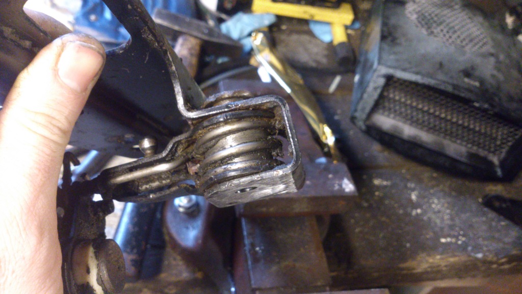

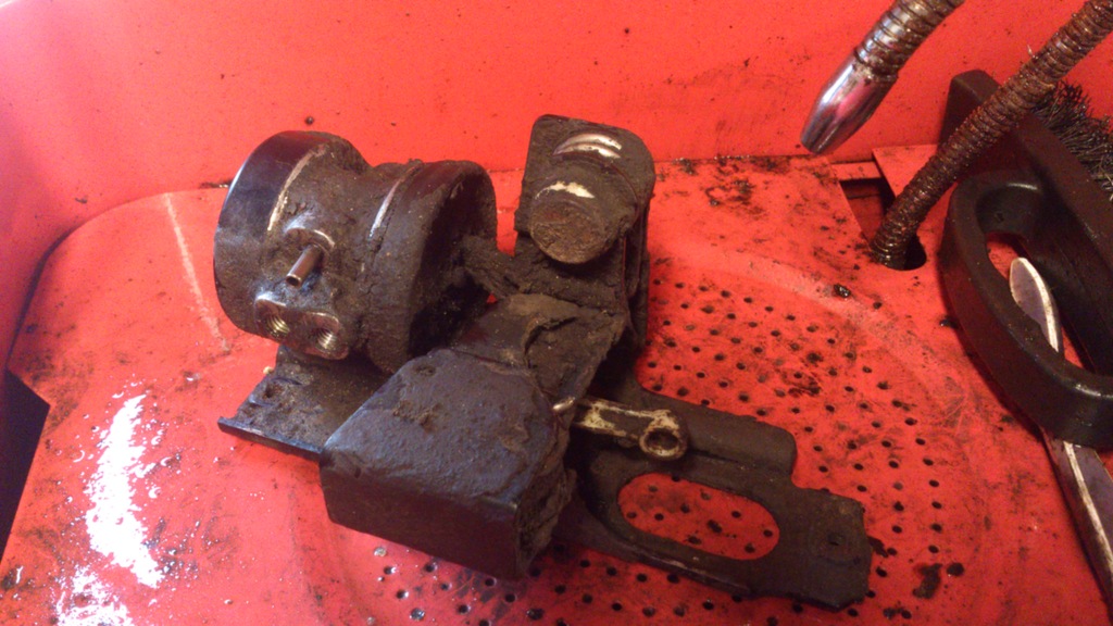

Major clean of the full thing:

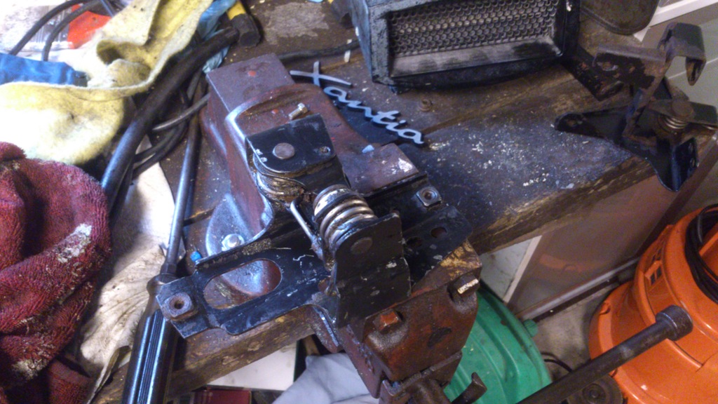

Cleaned up - gives access to the pivot pin

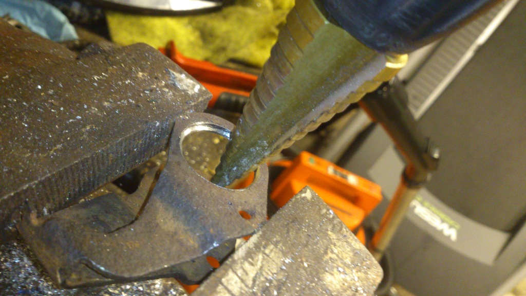

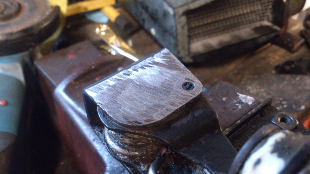

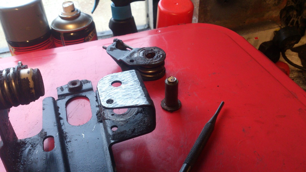

Angle grinder to remove the swaged end of the pin:
Using a vice or press with a large socket over thge other (bigger ) end of the pin and something small to press the pin from the ground - flat side

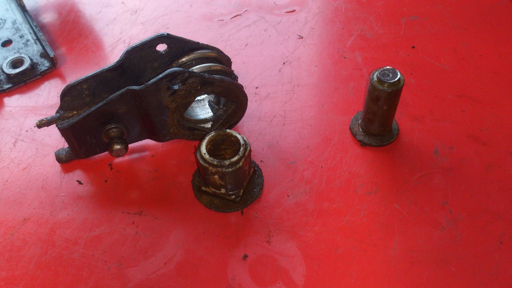

Then it starts to press the pin through as can be seen here:
Pin out, allows access to clean the inner faces.

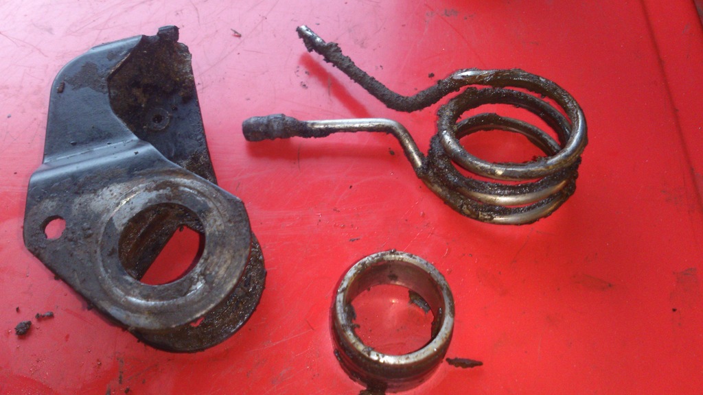

Then the plastic bush just lifts out and after the metal support and the spring.
The plan? not to simply clean and refit all this stuff but to improve the construction :-D

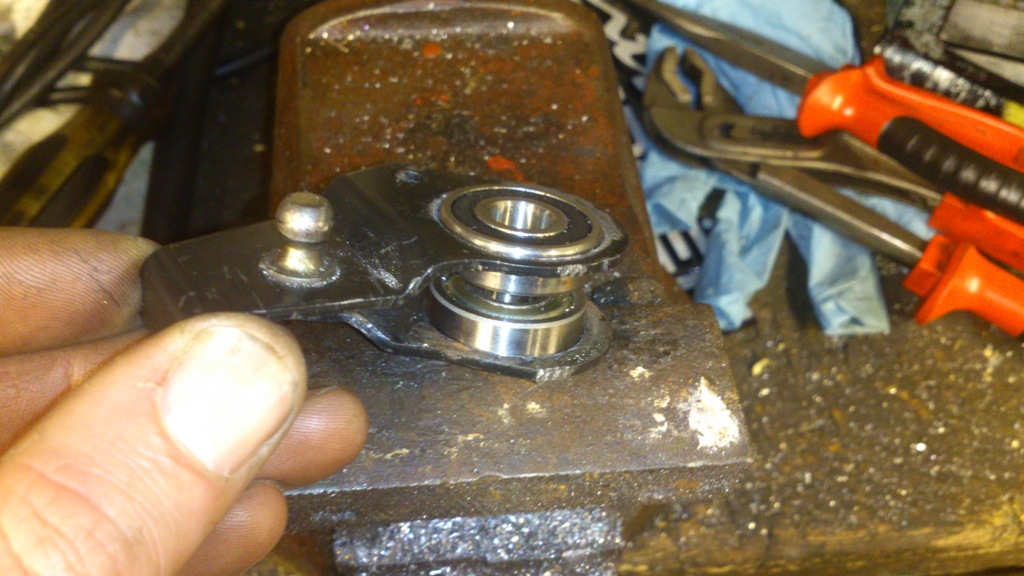

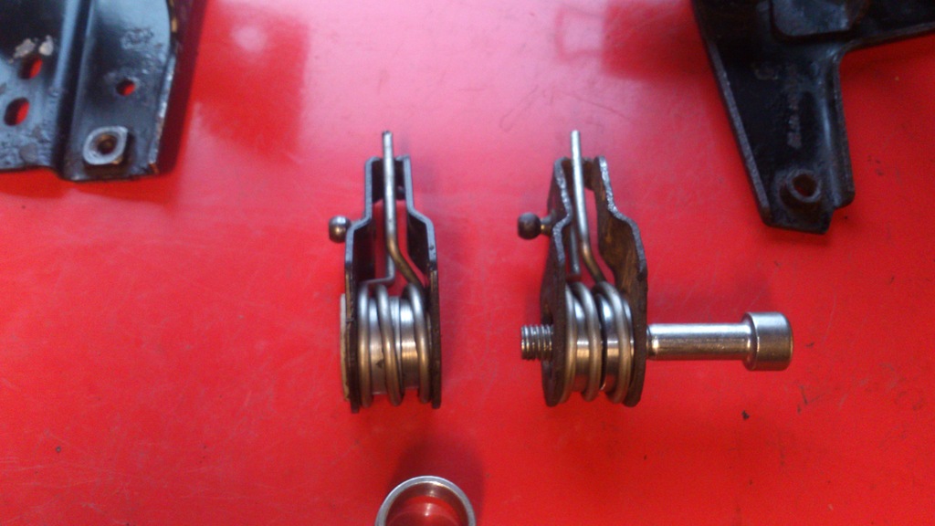

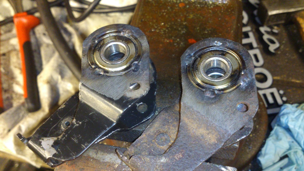

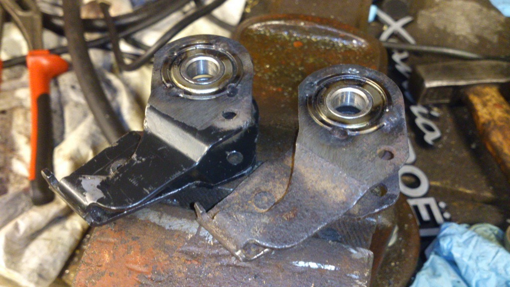

So once the lever is out and the bush, metal spacer and spring, the idea was to get rid of the plastic part altogether and replace with sealed bearings.
26mm outer bearings with 10mm inner size. These are the same outer dimension as the original metal support for the spring (it needs to be held to not move around)
Original left, with bearings, right
the metal guide seen removed on its own here. It's the same size as the bearings

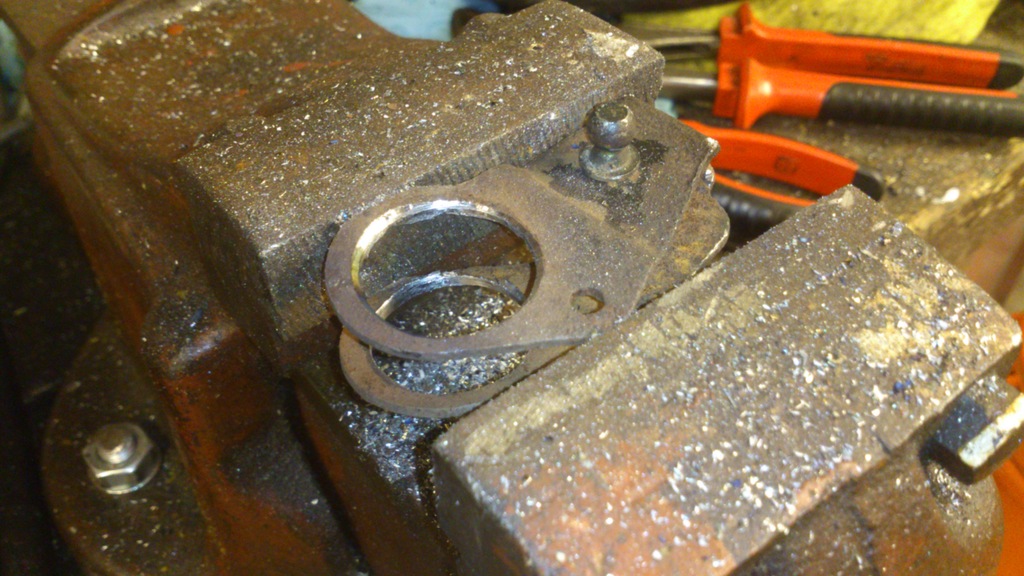

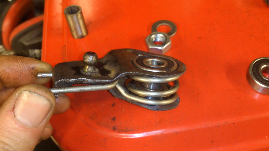

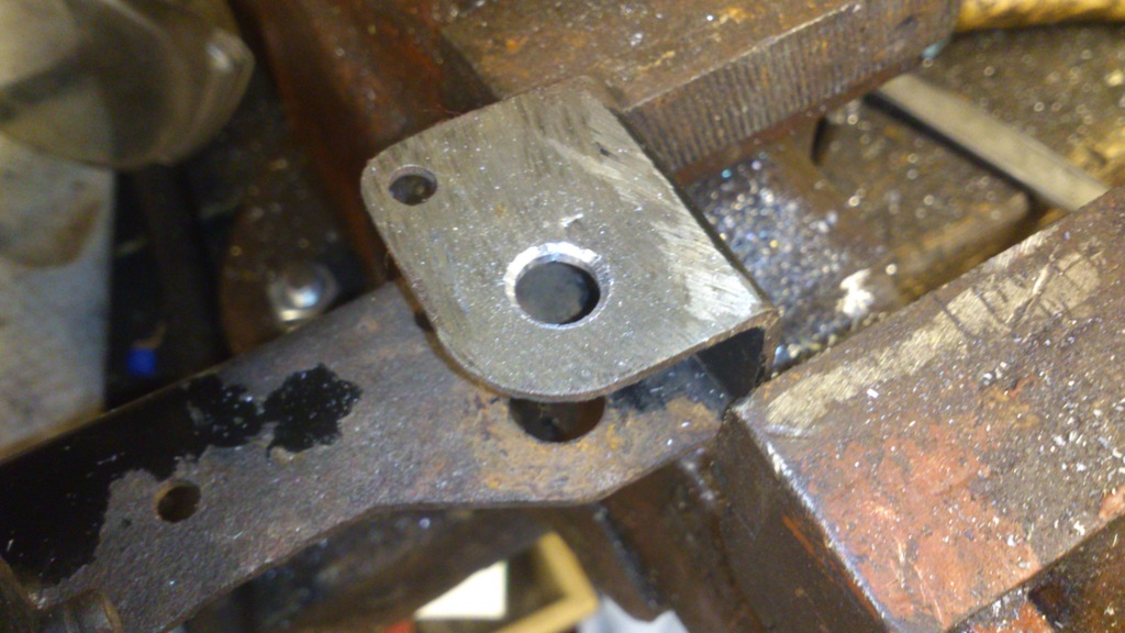

To fit the bearings in The lever needs to be modified to allow the bearings to be pushed in to place. I used a stepping drill to carefully open the 10mm hole to 26mm, and the square hole on the other side of the lever to be enlarged to 26mm.
And the bearings pressed in until flush to the outer surface.
The hole on the cradle needs to be enlarged to 10mm and countersunk to tidy the edge.

Cheers Harry, it's sealed bearings fitted in to replace the original bushing - I completed this a couple of weeks ago and it has worked very well so this is just a write up for interest.

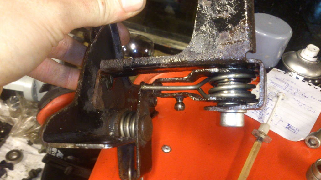

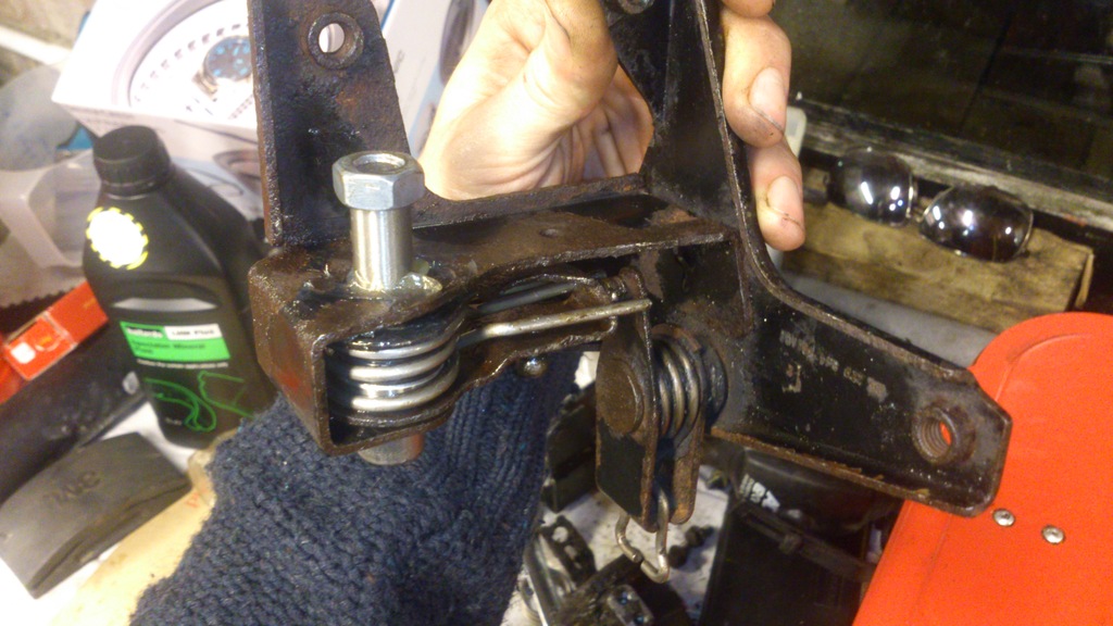

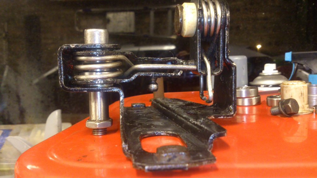

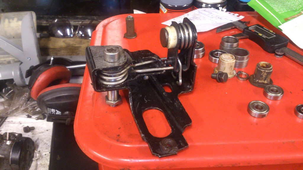

The next stage is to press the bearings in to a depth that allows the whole thing to fit back in the cradle without the bearings or lever ends fowling anywhere. The clearance is 25mm altogether, each bearing is about 8mm deep and the upper and lower bearing races need to have a washer betweel them and the cradle surface so after measurements and drawings is turned out that the bearings are sunk in to near flush, a 1mm M10 washer is needed on each end and a stack of 3 needed in between the bearings to space them apart. Then it all comes out for the bearings to be tacked in place with a TIG welder. This doesn't affect the bearings if done carefully.
A lever for the front and rear HC cradles each - they're identical it's only the cradle itself that differs.

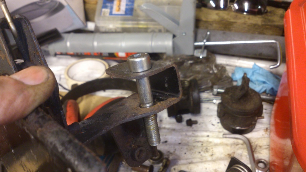

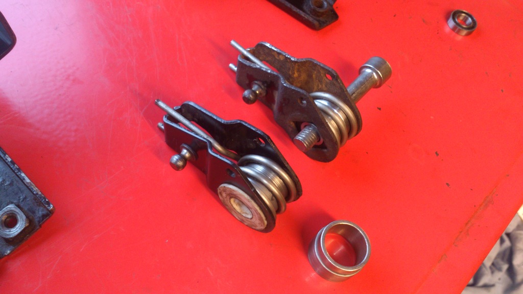

An M10 bolt is used to replace the original pin.
Bearings in, spring fitted as before and readly to be fitted to the cradle for adjustment (by one more of less washers to get the fit right)

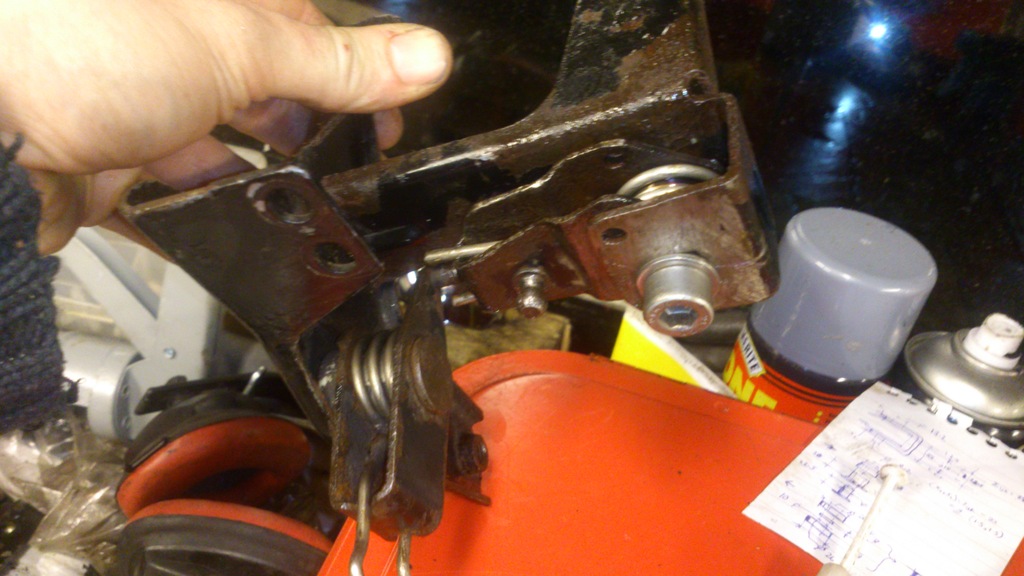

The M10 shouldered screw fits snugly in the enlarged hole but the hole on the other end The oriuginal, unmodified one is too large to locate the assembly securely so I made up a little locating bush out of a steel tube (think it is 10.5 inner diameter, 14mm outer) to locate in the larger hole, conveniently it also acts on the end of the bearing inner race to hole it well clear of rubbing on any of the cradle.
You can see the tube here and secured finally with an M10 nut. I locknut might be better though.
The final assembly

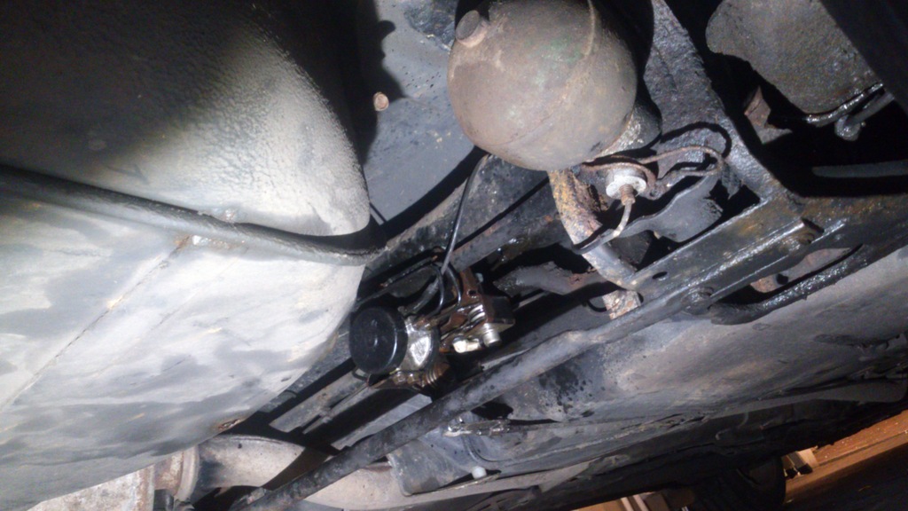

Fitted in the rear of the car and all the usual clearances and adjustments made
Best thing also on the Xantia design is the height setting is unaltered after changing out the unit.

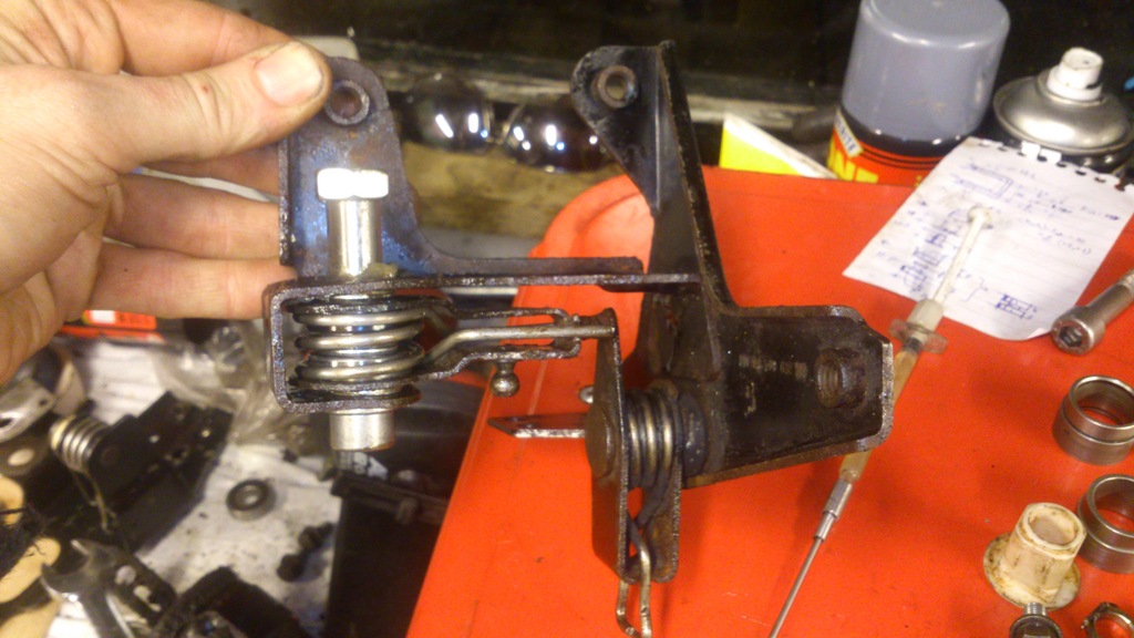

The whole thing is reassembled packed with grease. It is difficult to refit the spring and the washers but they do fit finally.
Here is the same treatment for the front unit.
I hope it is clear how it is constructed. And now on to the first unforseen problem!

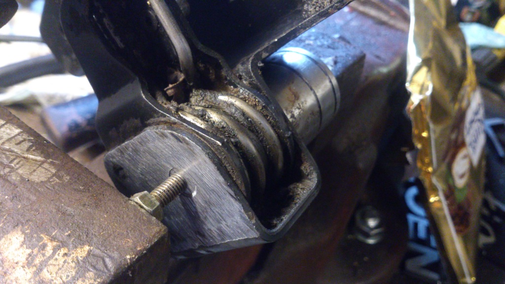

The one mistake I made was to assume that the spring that actually touches the HC extension to move it was tightly coiled around the original metal guide (part removed here, bottom)
The metal guide is 'stepped' and I didn't initially realise why. It is to allow the spring a certain amount of 'length' to the coils so as to let the spring move around the metal guide without binding. Trouble with the two bearings is they are both the same size so the spring was binding on them in use that had the effect of making the spring much stiffer when fitted. My fear being it would put too much strain on the plastic dog leg or the anti roll bar clamp rod (these can snap on seized pivots anyway) so the solution was to bend the long straight legs of the spring to slightly reduce the spring tension enough to stop the binding. Comparing it on the bench with one of the outgoing corrector units showed it was the same spring tension.
As an extra, the spring ends wear where they touch the HC valve extension and this extension piece wears little notches too so the fit between these needs checked for slack before it's all finished.
