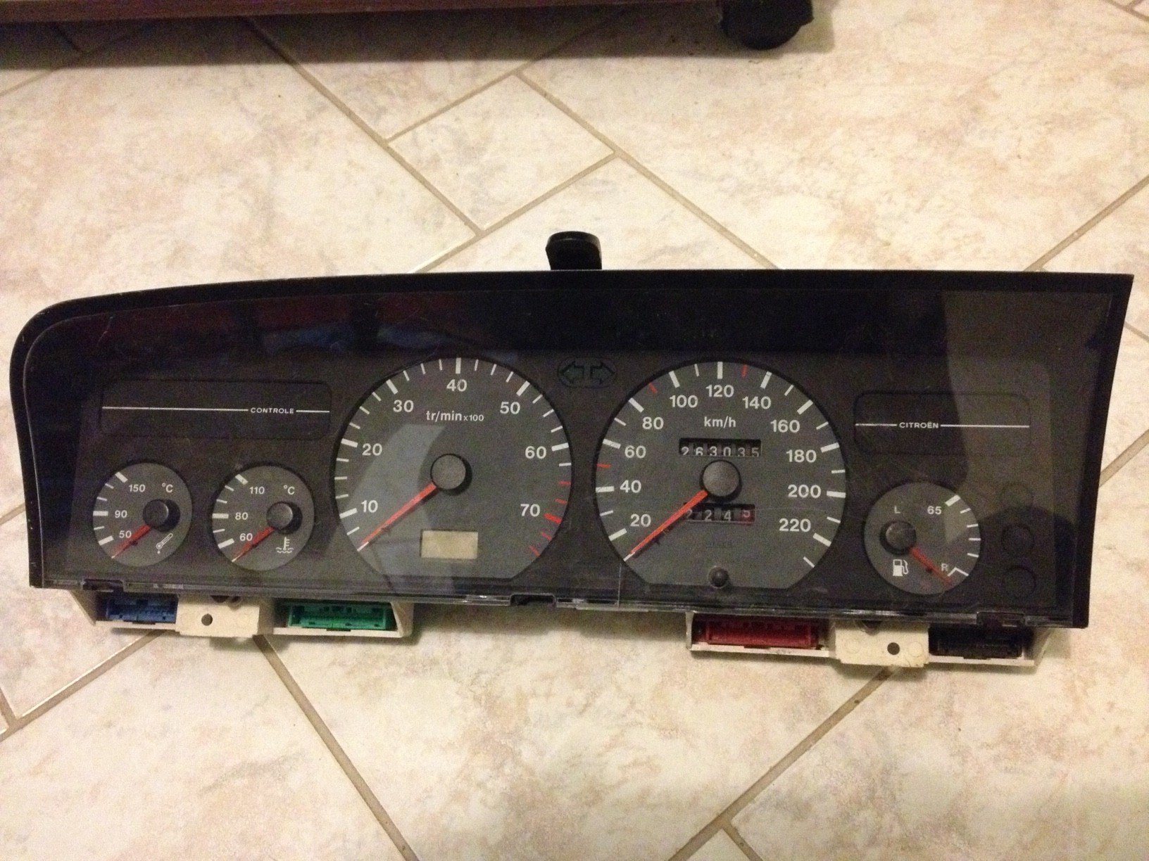

iam finally decided to continue the project to fit the activa clocks on my xantia. As i already said in a previu post my ca is a citroen xantia MK1 1.6i model 1993 with electric mirrors. I want to fit the activa clocks and to enable the oil temp sensor and the external temperature together. But i want a little help for the speedometer connectors wiring to find the appropriate pins that these sensors connect with the instruments. Is there anyone that has the wiring diagram for the clocks or someone that has already done this mod?

I see a big problem. If the top picture is from your 1993 Xantia it has a cable-driven speedometer. All Activas have electronic speedometers so if you want to use the Activa instruments in your early Xantia you would need to replace the speed sensor in the gearbox and do a considerable amount of wiring to make the speedometer work.
I can likely supply the wiring diagrams you need to do the work but I do advise it will not be simple or straightforward.

Thank you very much Citrojim and Stickyfinger for your answers.First of all i am sorry for the words "activa istruments". My clocks in the car dont have ext temp gauge and ol temp gauge. i found these iinstruments in the picture with those two additional sensors. i dont really know from what model is it but clocks have the two additional gauges. so he speedometer will work ok. the project is to find or create the approriate wiring for ext temp ans oil temp gauges. i really appreciate for yours answers and if you can supply me with the clocks wiring diagram will be wonderful.

The clock in the pictures are probably from a Vsx then which would have a cable speedo like your picture.
The external temperature sensor lives in the bottom of the door mirror on the drivers side of a RHD car in Mk1. If you have a little dark plastic dome on the bottom of one of the mirrors thats where it goes. They rarely work properly though, my Xantias have always thought its really cold compared to the real temperature. You may find a better place to put the sensor, it's just a thermistor and could probably be located somewhere easier to wire should you not already have the wiring.
As the 1.6 was never offered in Vsx or Exclusive trim I am not sure you will even have the blanking plug for the oil temperature sensor. You could modify it to have one but I'm not sure the amount of work you will need to do is worth it myself.

Thank you very much for your answer Elma. My car is a LHd car and i have an extra pair of mirrors for this mod that the left one on them has the sensor. My question is in which of the four connectors on the clocks(blue,gren,red,black) the two wires from the sensor connect and especially in which pins. The question is the same and for the oil temperature sensor.
