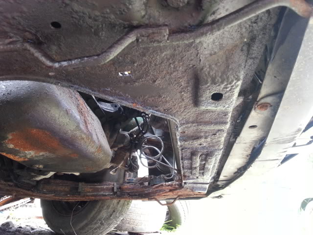

Well, found an hour or so today... so pulled the XM out to have a look at the nearside front outrigger weld I did a month or so ago.. well, its not fallen off, still sounds solid, so takled other areas of small rust parts..
Again, strangely, the off side is the same..
So peeled back the underseal as far back as the loose stuff would go wire brushed and applied Hammerites Cure Rust..
Thats the Scuttle drain hole, and its the same BOTH sides, pictured the drivers side, and the other is the outer section obviously by the strut head, which would of course be a serious MOT failiure. Thank the god heavens it is only surface ! Its still very solid.
How strange to be identical on both sides though...
Theres a couple of other small surface rust patch's to peel around and apply curerust, and under seal back up.
Of course, in my crazy working ways, I dont do one thing at a time.. so going between this and also refitting the carpet underlay, and floor carpet...
So getting there slowly now.. A GOOD couple of days maybee three would see the hole welded on the drivers side front out rigger, interior back together and the engine service and cam belt/Water pump done..

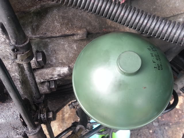

Water!!! Comming out of the seal joint... NO Its not LHM, that brake pipe goes up the other side, the opposing side of the structure is DRY! So, water being held, which having the car leaning in favour of the passenger side caused this water to seep out..
Any ideas??

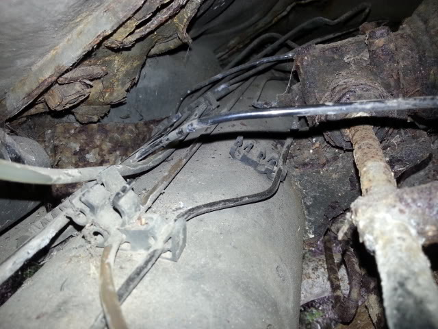

So, down with the rear subframe...
Little to no cleaning needed on them, Im rather impressed with their condition considering...
So, out with the spray underseal..
Nicely sealed up, not fancying any premature pipe bursts...

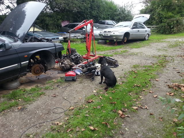

OK.. got the engine out today... and got a bit more done..
Id thought Id tackle the head first.. and stripped down and got the head off...

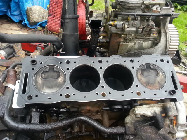

Heres the state of the gasket.
Gasket had split in two places on the edges. The head was not stuck to it like some I have removed in the past on the 1.9 engines. It lifted straight off.. Looking at that Im VERY pleased to be changing the gasket, and putting a MLS one on too...

So, gasket back in place, head cleaned up, head on, set of new bolts, tightend up and cam belt refitted.

PAS Pipes a tiny bit corrosive, so a clean up and application of Kurust ... and also long the top face of the subframe too...
Then I spotted under the rear lower engine mount point a load of crap around the mount..
So off with the mount to clear it out, and even after this time, it was STILL wet and damp.. not got for a Rot point of reason.. All cleared out, and Kurust applied.. NOTE in the second picture down its all cleared up and clean!
Just for piece of mind...
Nice new matching belts on the Aux side of things..

Got the engine and box BACK into the car, and front pipe connected to engine...
So during this week amoungst the useual other things I should get her all plummed back up and running with any luck!
Clutch, however, is beautifully nice and smooth and VERY Light!! :D
Engine plummed back in, bolted in place.. drive shafts in.. new accumilator sphere fitted... rads fitted .. water in with 3.5 litres of anti freeze, not sure if thats enough or not.
Ran up to temp.. all ok.
