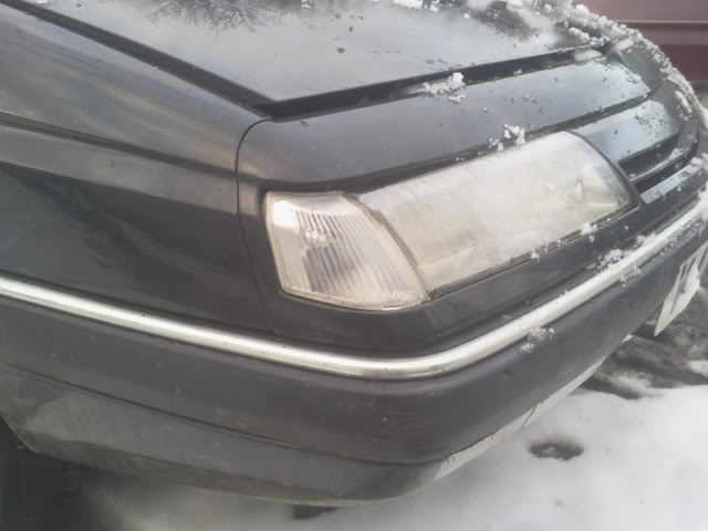

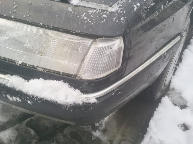

Good pair of side lights

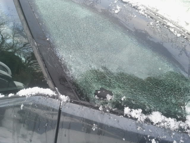

Rear passenger quarter glass been smashed. shattered with a small hole in it.. Grrrrr these are impossible to change. not sure what Im gonna do with that.

Worth it for the side lights alone.... :D :D (above and below)

The Broken window above.. grrrr
