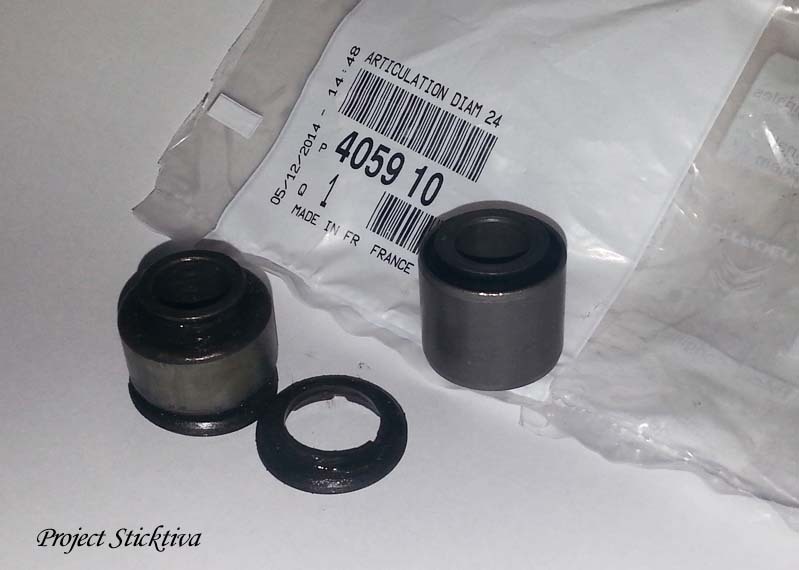

Pug bush has arrived, it is the same bush....
So....Activa ram bush is not NFP...........errrr..EDIT BELOW

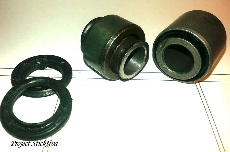

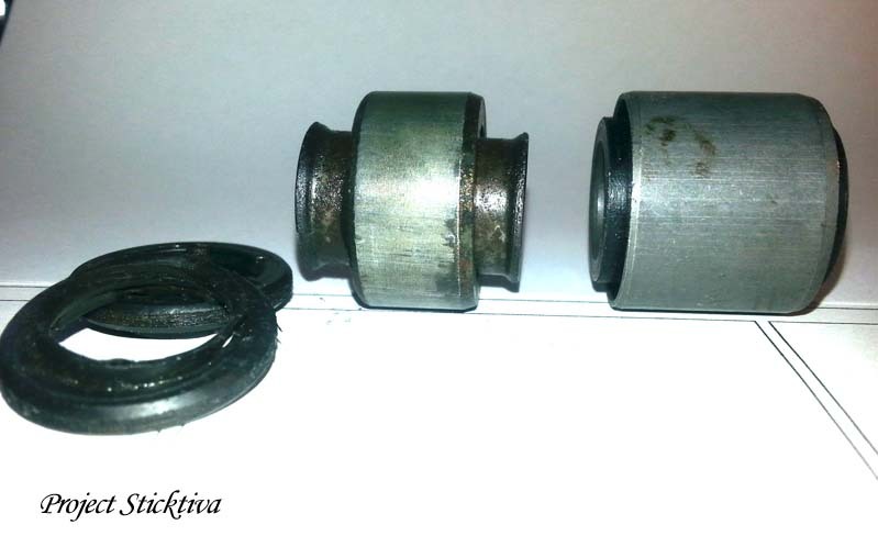

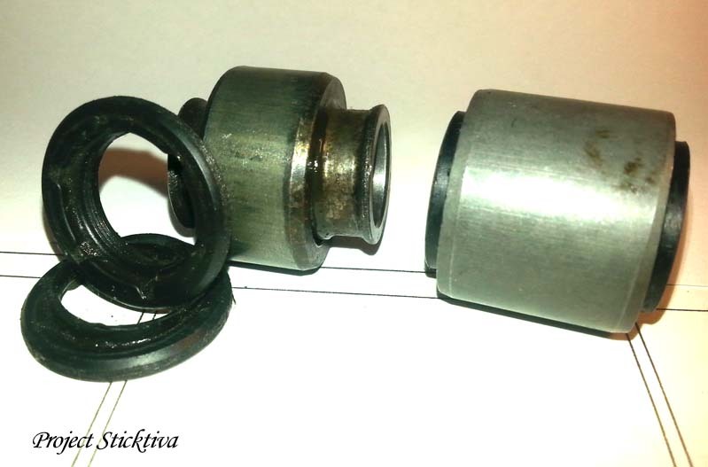

The Peugeot bush IS DIFFERENT.
Details of the two Bush's, why the NARROW outer Tube on the original Citroen Ram Bush ?
Total width is exactly the same
Note: the inner tube on the Citroen Bush has been pushed over to one side to show the inner "lip" of this item.
You can see how thin the rubber is here, ?? how this design would last more than a very short time is hard to know

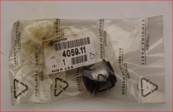

|Guess what I found....now, will he send it to the UK ?....I await the reply to this request.
I plan on using this as a MASTER for reproducing the pattern part which is NFP
Note: it has "Made in C.E.E.".=.Central and Eastern Europe, anyone know the factory ....poss in the Czech Republic ?
Edit
(anyone in France want to get it for me if he says no ?)

You can have it sent to me if it helps. BTW I think CEE is the frenh version of EEC, not a reference to eastern Europe.

Cheers....I will let you know what he says....I have PM'ed you the link to the vendor....it will be nice to have an original to copy from.
CEE.....agh.....and I thought it may be "standardised" EU speak.

Sticky, that part above (405911) is available directly from Citroen & Peugeot for £11.59 including VAT before you haggle any discount!
How much is the one you've found?

Tried, parts department said NFP mate
