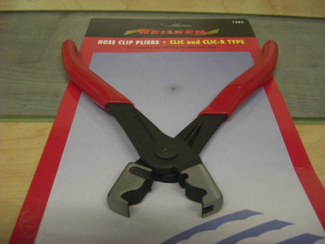

Out of interest citroenxm, what do the proper clip pliers look like so I can source some?

citroenxm
- Fallen Hero
- Posts: 8061
- Joined: 30 Dec 2004, 23:10
- x 70
Re: Xantia front strut leakage returns
Ask me again next week when im home to take a pic.. let me see if i can find an add for some.

Dommo
- Posts: 1210
- Joined: 11 Apr 2009, 09:43
- x 20
They do look similar to the tool we have, ours differ in that both jaws have the cut out in them, and they don't open as much as those ones. I think they're a pair of cutters to remove the insulation from around a cable, but they seem to work for the type of clips that hold the LHM pipes to the tank.
It would probably be worth me getting some proper ones for the job...
