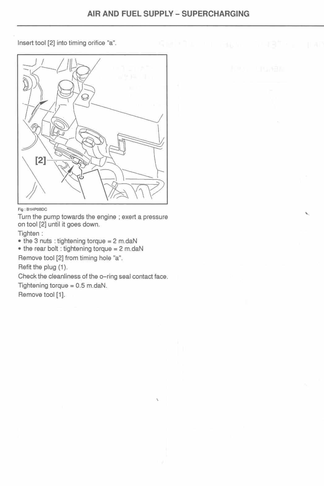

Before worrying about dynamic timing, do the static timing first... If you don't have the official words on how to do this I do and will happily send it your way.. It's very easy to do and if the static timing is right then there should be no need to do anything else as the dynamic timing is under ECU control so as long as the lift sensor is working it will be good.

Here it is. Epic Static Timing:
Page 1
Page 2
Part of the work you have already done ..
Hope that's OK...
