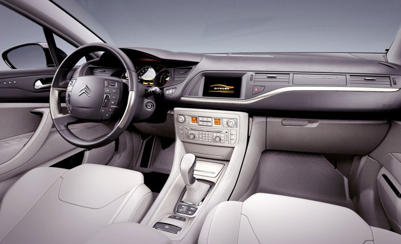

If you don't have a mechanical handle (classic solution), but rather a short flap that's resting below the handrest, than that is the electric handbrake ...
EDIT: just to add, I remember having some discussions about the two different handbrakes in the X7s, possibly with qprdude, a few months ago ... and I still believe that the classical lever is way safer, in terms of it working or not, I don't like the idea of the car being able to lock the brakes on a whim, whatever the reason ...

Yes, it's as per your picture.
Very sleek in the pic than real life, btw.
