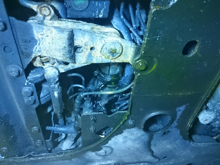

Well, as if my own Activa springing a coolant leak wasn't enough, it seems that my Dad's Activa has also decided to throw a spanner in the works, in an even more annoying way!
It's had a slight weep from the front Activa ram since we bought it a few month back, but in the last couple of days the leak decided to get a lot more serious. Getting it up on a ramp allowed us to see the full extent of the problem - it is in fact a new leak from the steering rack.

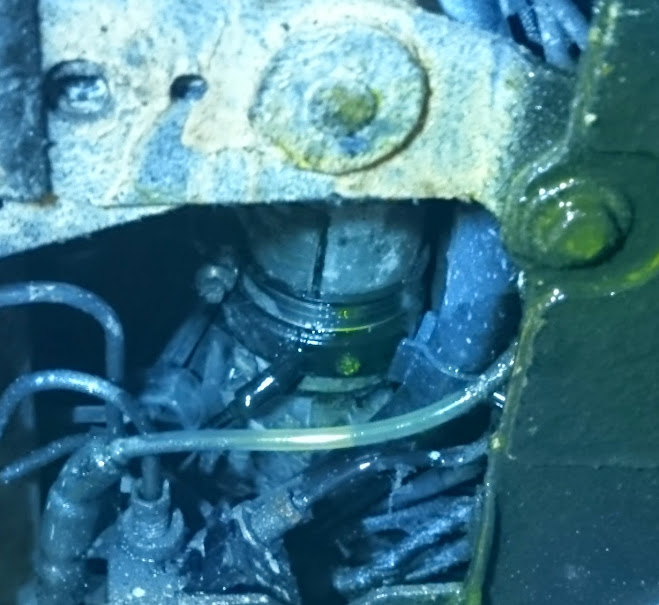

Close-up...
Firstly, what is it that's likely leaking? Secondly, Is there a way of repairing it in situ, or is a recon rack needed (in which case, should I just go ahead and do that V6 conversion now? :lol: )

Need to clean it all up to see where it's actually leaking from. IIRC the pinon seal can fail and then it leaks. You can put new seals in the pinion valve, but it's not exactly easy! The brake valve leak off is also right above there, and if that leaks it can throw LHM everywhere!

Matt, am I correct in thinking the leak is on the nearside? It's hard to tell from the picture but if so then what appears to have the LHM drip on it is the steering ram leakage return collar..
It could be a leak from way above though, perhaps the security valve or anti-sink valve under the LHM reservoir..
As Richard says, a good clean-up is needed to be sure...
If my assumption its the nearside than the pinion valve is likely OK but if it is the culprit then Pleiades are the best route to repair. As Richard says, the resealing is a tricky job.
If it's the steering ram then the leakage return collar can be replaced with an XM one - the same as used in Activa ram repairs - but getting the ram off to do the job is tricky... It might be easier to remove the rack complete...
