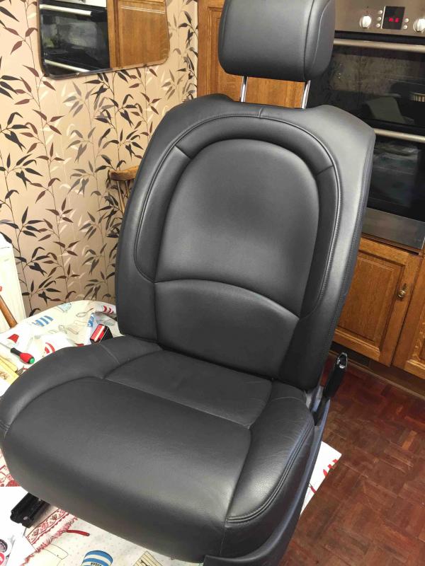

It's certainly progressing at a good rate David, the seats look very nice. I'm a fan of the gliptone leather cleaner and conditioner myself, smells nice too.
Mark

Well Fedex turned up this afternoon with another present for the C6. It was the last piece of the puzzle. The one airbag we needed to get finished - the passengers seat airbag.
I'd stripped the seat down yesterday as I was hoping it'd arrive today so half an hour saw it back together.
New airbag fitted...
Seat reassembled, cleaned and treated with 3 coats of leather conditioner...
Both front seats are now refitted into the car, unfortunately they're only held in by the front bolts at the moment though. I need to reconnect the battery to power the motors to slide the seats forward to tighten the rear bolts. I don't want to do this until I've received the airbag ECU back and got everything reconnected.
All I've got left to do now is reconnect the airbag ECU and rebuild the centre console, and then fit the new N/S rear set airbag into it's new trim which should be here tomorrow and the car is finished.
If the ECU and the piece of trim arrive tomorrow then an hour tomorrow evening should see the car finished
David.
