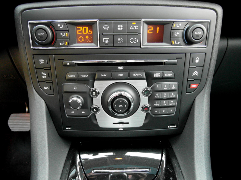

This unit is the RT4 and RT5 system and is made by Magneti Marelli
Main differences between RT4 & RT5 - RT5 has Bluetooth Hands Free, faster Navigation calculation and on C4 & C4 Picasso only, USB ports and a High-Res screen.
