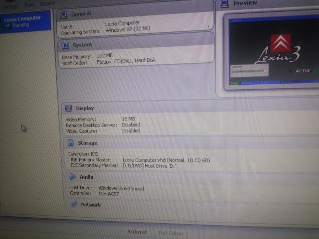

Basically with a virtual machine there will be an option somewhere in the menu to "pass through" specific USB devices, so that the virtual install of XP can "see" the Lexia interface instead of Windows 7 seeing it. I just don't know off hand where that is in virtual box.citroenxm wrote:Ill post on here if I get tripped up when I plug lexia into the USB after install....

Ive got 2 gb on my Main laptop.. and I think I gave the Virtual Laptop a 200mb memory and 10gb hard drive.. I think..

You might need to increase the memory allocation for XP to about 500MB otherwise XP may run really slowly, (try it as is first though) but with only 2GB of total ram (which is marginal for Windows 7) I wouldn't set it any higher than 500MB otherwise Windows 7 will be starved for memory. Bit of a balancing act with that amount of total memory.citroenxm wrote:Ive got 2 gb on my Main laptop.. and I think I gave the Virtual Laptop a 200mb memory and 10gb hard drive.. I think..

Ive plugged Lexia into the USB and nothing has happened....

You can change the memory allocation at any time. Just shut down the virtual XP then go into the preferences in virtual box and change the memory setting then start XP again. It won't let you change it while XP is actually running.

Paul, did you install the virtual box extension pack ? It's a separate download that you need for USB pass through to work.

Nope, but I selected Two USB filters is the settings and then it found the Lexia in the USB port, so its all activated now and working!
I cant thank you and Ben8 enough! Ill invest in some more memory when money allows, its a Samsung E352 laptop, no idea what the memory boards are. Ill open it up and see if I can find them and get an idea..
Ill close it all down now, reload, and re connect lexia and see if it works straight off..
