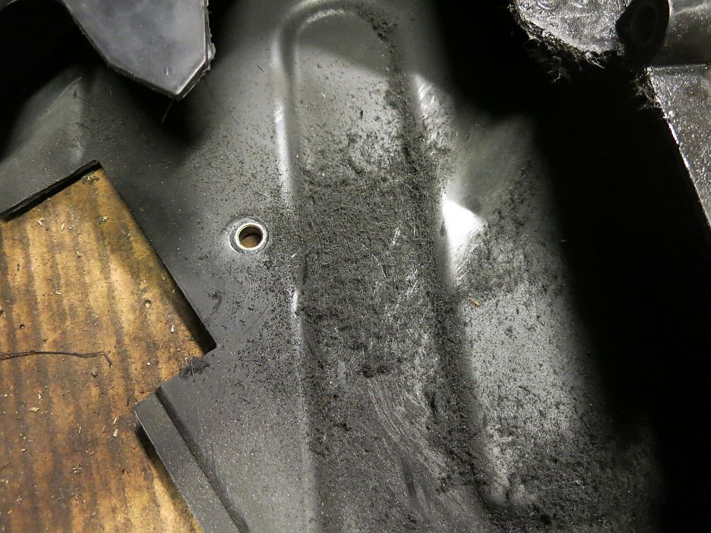

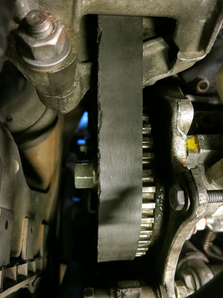

Pictures of the timing belt
The picture does not show clearly how far out the timing belt is on the sprocket.
But however some damage incurred before I removed the belt covers.
Picture of the timing belt cover
Showing how the timing belt taken, against the timing belt cover
//Jan

Jan, that is a serious problem... Indeed the belt is running well off the edge of the sprockets and it will soon fail.
I would suspect that the tensioner pivot bolt has broken or the tensioner jockey wheel bearing has failed allowing the tensioner to sit at an angle to the belt and pull it off line. A similar problem happens with the auxiliary belt tensioner which works on a similar principle.
I have seen this problem (and the rather dramatic final results) once before on an XUD engine.
This problem must be investigated and resolved before the engine is run again.

The tensioner has failed in some manner - probably the bearing if it's anything like my old 1.2 Punto which exhibited the same symptoms.Albireo wrote:Yes! I did it

I'm not as afraid that something will happen right now. It has probably been on this way many 100s of km.
Checked the tensioner roller and could not see / feel any problem.
(I don't know how to lock the crankshaft in the right way, on the car with automatic transmission)
Now it's important that the new diesel pump really works well. (do not intend to buy a new pump for the car)
But if I have made ??the situation worse by stretching the timing belt in the wrong, way or done something else wrong...
My idea was to test/check the car before the next challenge, (including new timing belt.)
But if it impossible to get the timing belt on the right place now..
And the risk that the timing belt wanders further outward...
Sure, I can buy a new timing belt, water pump and tensioner, but if the problem with the timing belt still exists?
(and I'll have any other problems, with some other electrical sensors... )
Right now I see no light in the tunnel and do not really know how I should proceed.
//Jan

Jan, I would replace the belt and tensioner now.
Also, whilst you are there it is best to also replace the water pump even if it seems OK as they are relatively cheap and often just after you replace the cambelt you find the water pump fails and you have to do the job all over again...
I am sure a new belt and tensioner will resolve the problems.
