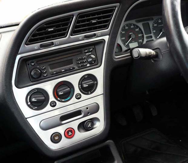

What might help, is if someone with the factory schematics posts up. Does it have three round dials like a Berlingo?

what do u mean by 3 round dials? where are they located and I will have a look.

For the climate controls - like: a temp dial, a fan speed dial with recirc/fresh, and an output position dial.

there is one for fan speed (including turning it down for auto a/c), one for output position and one for temperature. Same as:
http://www.cqout.com/item/Peugeot-306-B ... s/16053669" onclick="window.open(this.href);return false;

Bugger. I don't have a schematic for that one.
