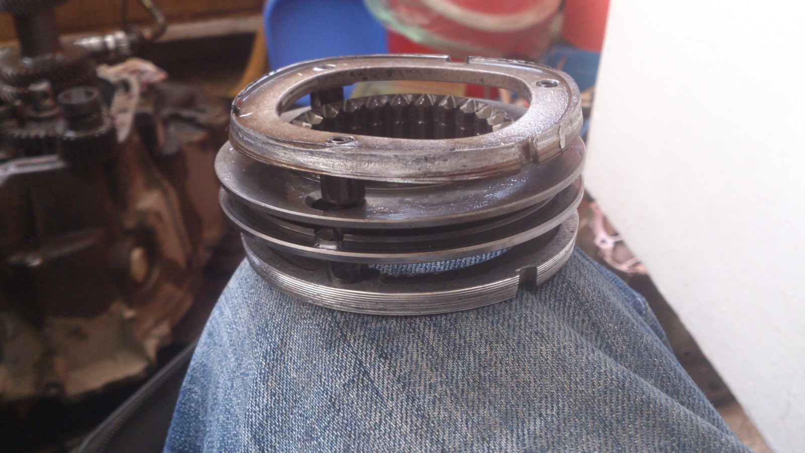

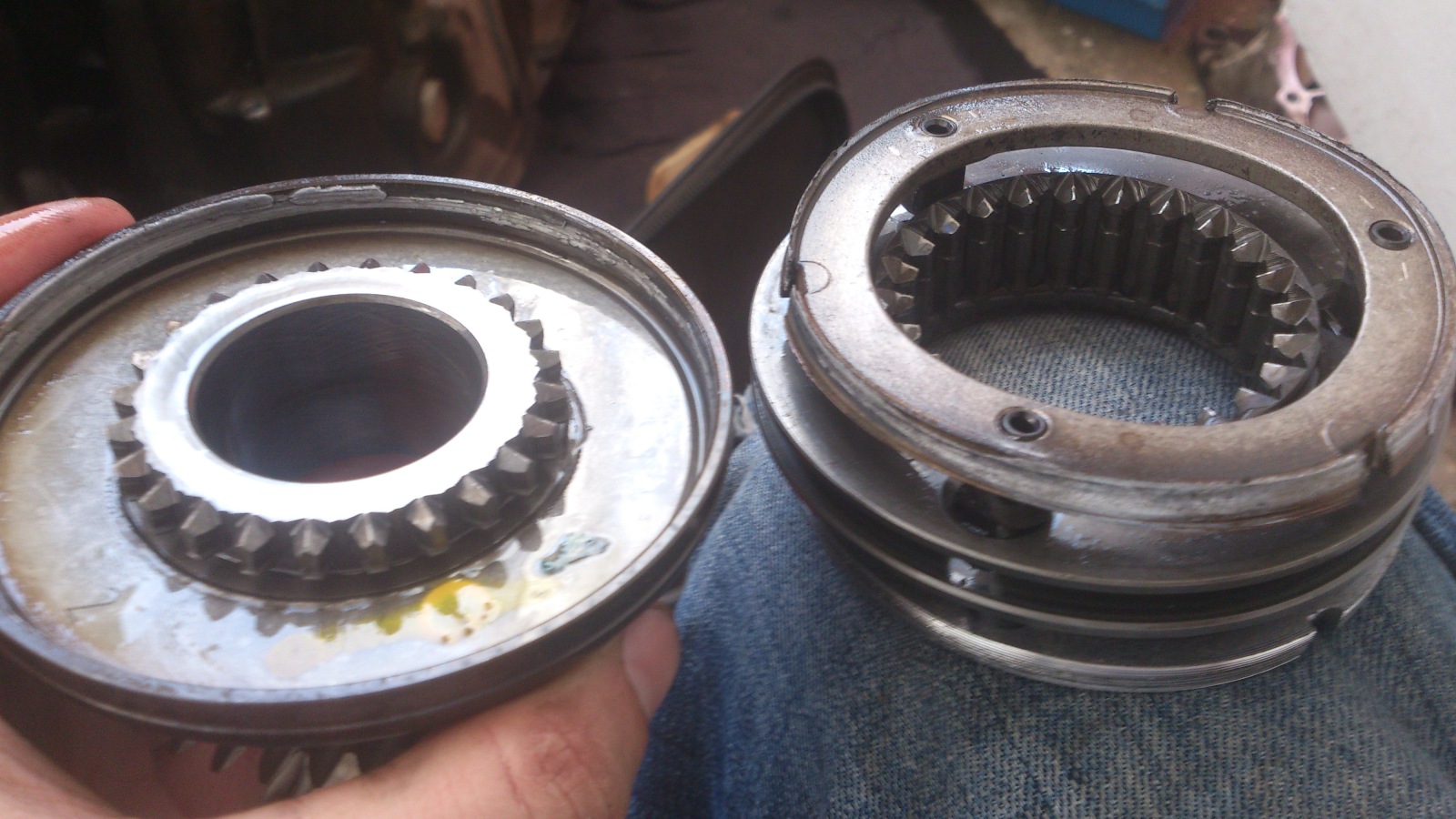

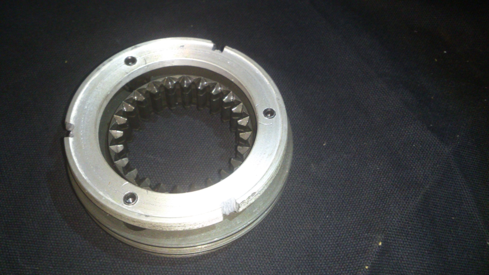

Dear colegues, bad news. Today I managed to dismantle the gearbox because I had problems with fourth gear.
I found this in gearbox

Succes, yesterday I managed to mount the gearbox and it works. The syncro hub ring was made at a turning shop. The clutch is new and it feel very soft but I have a little problem....sometimes does not want to enter in gear, particularly in 1,2, 5 and reverse, but sometimes works fine.
Any advice is welcome.

The clutch kit is new, is a Sachs. Peter, I think too the clutch is not disengaging properly but it's weird...sometimes it works fine
This is the new syncro hub made on turning machine.

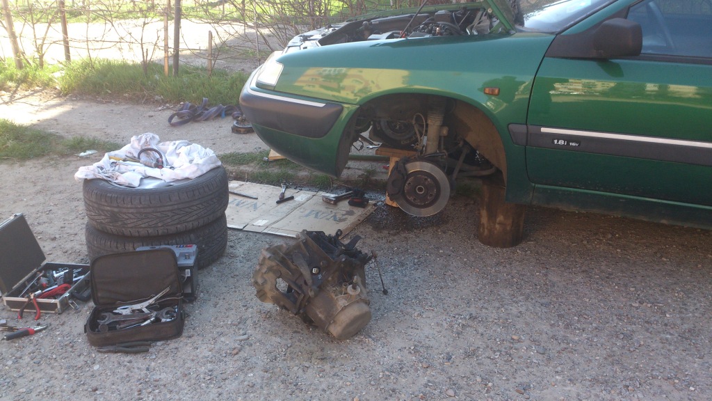

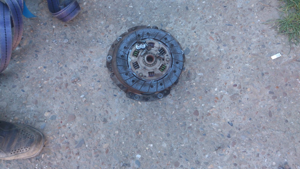

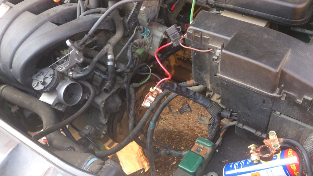

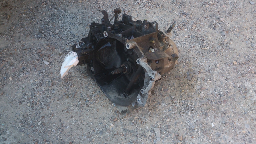

Some pictures from the start:

I could have used some engineering skills like that. There were so many scrap vehicles over here that spares were not that expensive.
