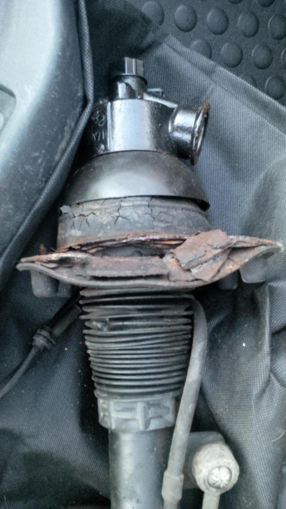

I finally managed to collect the struts from Will the other day, but as per normal, time hasn't been on my side, they're still in the boot of the C6, which is where I put them to fetch them home, It's looking like it's going to be Monday at the earliest before I get chance to have a look at them, one of the strut top's is most definate F....... err..... beyond economical repair

The Tops is useless for a S1 WITHOUT The Spacer! If theres no spacer in the feed hole Steve one will need to be made or obtained, though, I know a man who can make them..
Its advice for your potential person who wants one depending what eira of Xantia they are fitting it to...

1997 same year as mine buddy, here's the posting: http://www.frenchcarforum.co.uk/forum/v ... =7&t=46831" onclick="window.open(this.href);return false;

Re: V6 Xantia......... the beginning of another adventure
Ah, wasn;t Wills a Series Two car?
Then they will DEFO need a spacer for it then! I fitted a Series Two top to a VSX and it needed the spacer before it would seal.

Yea it was... S2 tops are drilled deeper in the feed pipe orface, with a small step, and a stepped spacer needs fitting for the feed pipe to seal up properly.

Well, the bit in all that, that made any sense to me was the bit about the W reg Xantia
after that it's double dutch......
anyway, here's a couple of pictures of the "beyond econimical repair" strut top
and here is the other one,
which you can see is beginning to go.....

That better one is FINE steve, Looks to be a NEARSIDE one, Im sure they Point OUTWARD slightly in the straight ahead position.
The rubber needs peeling away fully, and the metal plate needs treating to protect the plate, which actually still looks perfectly fine..
