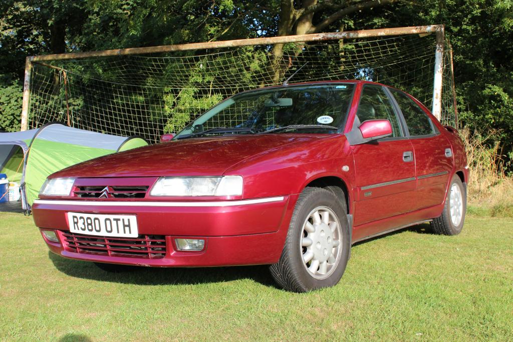

Some of you know that I've bought Roger Bradford's old Xantia 3.0 V6 Exclusive, the car has been looked after by the previous owner's, however, as you would expect with a car that's 16 year's old there are a few things that need attention:
* Head light not working - Now Done
* N/S/F door lock cap needs replacing - Now Done
* The LED on the dashboard need's replacing - different to the one I got off Paul - Now Done Thanks Malcolm :-D
* The switches on the drivers seat, need replacing - Now Done
* The heater matrix has gone - Now Done
* The headlight bulb's need changing for something brighter than the current 'candle power' - Now Done
* The leather needs a bit of TLC - Now Done
* Various cap's and cover's are missing - Now Done
* Rear parking sensor's need adjusting - Now Done
* There are only a couple of lights on the gear selector that work - Now Done
* There are a number of dashboard light's out - Now Done
* There's chrome numbers on the back of the car that need removing - Now Done
* Front number plate is 'cockeyed'. - Now Done
* Rear height corrector sticking - Now Done
* Exhaust is nosy - Now Done
* LHM Leak - Now Done
* Replace front fog light bulbs - Now Done
* Heater blower not working - Now Done
* Grease spare wheel carrier - Now Done
* Water Pump - Now Done
* Timing Belt - Now Done
* Replace Heater panel bulb - Now Done
* N/S/F drop link has play in it - Now Done
* Front Disc's and Pad's need replacing - Now Done
* Rear Disc's and Pad's need replacing - Now Done
* The ultrasonic's are knac........ not working correctly :wink: - Now Done
* Intermittent starting problems, requires the mod - Now Done
* Air Con needs checking and re-gassing - Now Done
* Intermittent gearbox multifunction switch - Now Done
* The Cruise Control doesn't work - Now Done
* The boot light doesn't work - Now Done
* Replace broken steering column shroud - Now Done
* Replace chipped and cracked windscreen - again :roll:
* There's a nick in the drivers doorcard.
* There's only one key.
* There are a few dint's that need addressing.
* There's a few places where a bit of paintwork needs correcting.
as I say nothing to major, just things that need doing, Paul (CitroenXM) and I have a loose time frame of getting things done over the next few weeks, the first thing's being the matrix and the head light bulb's. after we come back off holiday.

Trainman
(Donor 2018)
Posts: 2593
Joined: 21 Aug 2009, 11:58
x 43
Re: V6 Xantia......... the beginning of another adventure
Unread post by Trainman »
Here's a few more pictures:

Are you leaving it with Paul for a few days to get bits done at all Steve? If so could i grab a lift when you go to drop it off and then i could bring you back in the XM?
Looks very nice indeed and some bodywork touching up from you should see it super lovely :)
Number plates are a PITA and best to be screwed on or really clean the surface behind them for 3 sticky pads to work and do it when semi warm as well so the number plate contracts most of the time and keeps it tight and straight instead of bowing out so much :)
