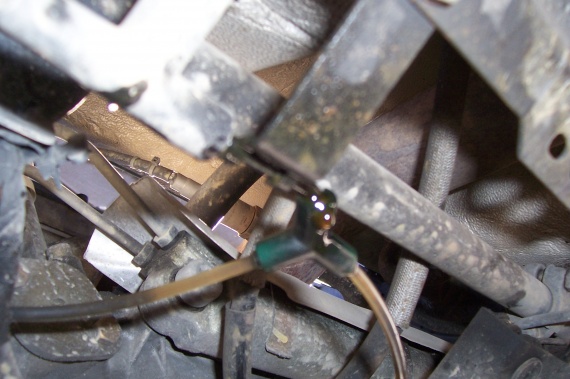

Does it look like this? I have posted this long time ago for another member's leak case.
Since they are return pipes they are easier than the supply lines. As you can see those
pipes are "pop-in" type.

Thanks for the reply, that's good to know, would you be able to point me in the direction of the connectors you used? I've found some brass ones, not sure if they'd be suitable...Stewart(oily) wrote:I have repaired return pipework using plastic push on connectors and fuel line suitable for diesel, I got the connectors on ebay and the line from my local factors.
VertVega wrote:Does it look like this? I have posted this long time ago for another member's leak case.
The pipes pop into the connector but it looks different to what you've posted - I found this picture whilst trawling old posts trying to find a name for the bit I'm after; I'm after the connector the arrow on the left is pointing to...

You mean the ones over the rear sub frame
The one I sent was in front sub frame, under LHM tank, close to steering pinion valve.
Any way the idea is same, pop in type and return line with no high pressure issues.
You can easily find them from scrap yards and they are almost with no value for the owner.

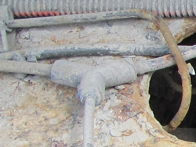

Edit: Here's pic from a scrap car. As far as I remember Y-link material is not metal but plastic/rubber as in my above pic's 4-way connector. This one would be the one on the right side in your pic
Both left and right are same.

Edit: Here's pic from a scrap car. As far as I remember Y-link material is not metal but plastic/rubber as in my above pic's 4-way connector. This one would be the one on the right side in your picBoth left and right are same.

if its the three way union in the last picy above here is price and part No. from citroen ( cough cough )
Part Number Description Quantity Price excl. VAT Price incl. VAT Total incl. VAT Selection
5451210 RET TUBE SLEEVE 12.65 GBP 15.18 GBP 15.18 GBP
one of the plastic pipes going to this union comes from the safety valve
theres no problem disconnecting these union as they dont have any pressure in them,
as they are just seepage/capillary returns

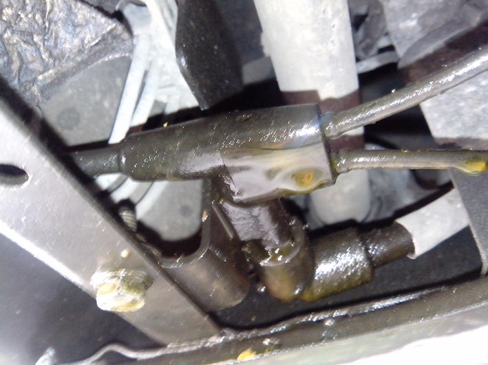

Hi VertVega,VertVega wrote:Does it look like this? I have posted this long time ago for another member's leak case.
Exactly this part has cracked and LHM is leaking in my car. Can you please help me with the part number?
