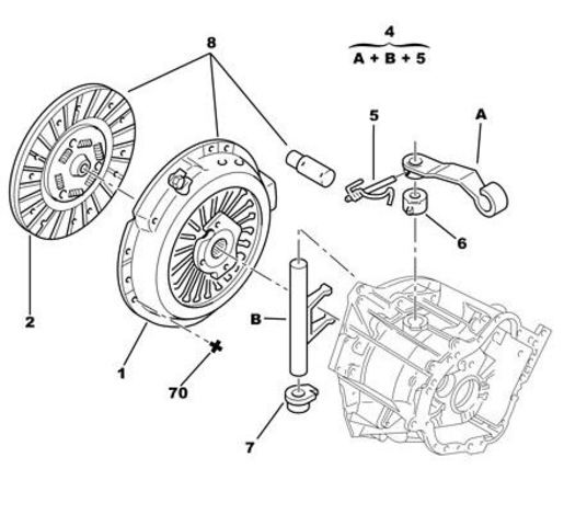

ahhhh, found it. This pin thing :)
No. 5 in below image yeah?

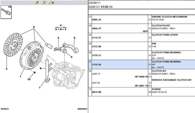

lexi wrote:I think it may be an idea to replace the white nylon top hat bushes in release mech.
citronut wrote:.....and fork shaft nylon bush's...
I presume the above two comments are of the same thing?
If so items 6 and 7 in the below image? :)

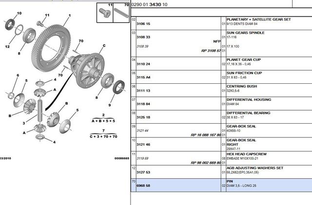

citronut wrote:...it pays to fit new diff seals...
Items 9 and 10 in below image?

Unread post by RichardW »
I think I looked on e-bay not long ago, and there were some of the bushes, but they were at least as much as the dealer price (which is not disasterous!). The pin sometimes refuses to come out - the only thing you can do then is cut the arm off and replace it, as you can't get the box off otherwise. You would be best advised to replace the inlet shaft / seal guide tube, which again is not that dear from the dealer (and used to be available from GSF I think).

RichardW wrote:I think I looked on e-bay not long ago, and there were some of the bushes, but they were at least as much as the dealer price (which is not disasterous!). The pin sometimes refuses to come out - the only thing you can do then is cut the arm off and replace it, as you can't get the box off otherwise. You would be best advised to replace the inlet shaft / seal guide tube, which again is not that dear from the dealer (and used to be available from GSF I think).
Do not fit a Transmech clutch. Valeo (OE) would be the preference, but Sachs is probably OK.
ah, many thanks!
My alternator is Valeo. Cheers :)
These bushes, the dealer said he does not carry them in stock and so I have to buy the number that comes in the bags!
Clutch fork bearing top £2.18+vat MOQ of 5!
Clutch fork bearing bottom £2.83+vat MOQ of 4!
grrrr!
"replace the inlet shaft / seal guide tube", I need to figure out what these are :/
Thanks RichardW, romie :)

Unread post by addo »
Try AEP in Glasgow, or Neat Car Parts for the fork bushes each. You might also try Gearchange who are on Ebay.
The part you refer to most recently is the tube which the thrust bearing slides on, and carries both the front bearing for the gearbox input shaft, and an oil seal. Can be had aftermarket as well, none are dear.
