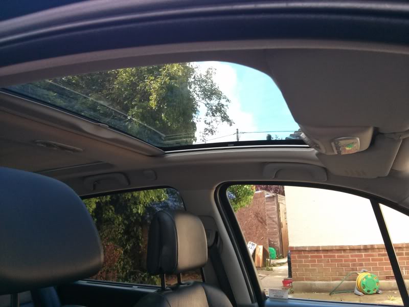

The sunroof is not working... maybe it needs a reset and a battery removal?

The sunroof does get lazy with lack of use, it's quite often the dial switch - remove it and get some electrical contact spray into it. Electric windows are also a very common failure, it'll likely need a new regular.
