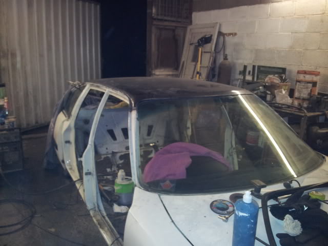

davetherave
Posts: 880
Joined: 01 Apr 2009, 21:06
x 4
Re: My "love" of all things xantia...and Xm...and Cx..
Unread post by davetherave »
Lol it will be having a full respray and all welding taken care of over the coming months!
This is some week off work, i ache all over! Lots of grinding!
We tested the fit by putting in the screen when the roof was tacked in and the gap was consistent.fingers crossed it should line up perfectly! More pictures when i remember to take them2 morro!
She won't be concourse but will be damn solid and useable! She should also be getting a galvanised rear sub frame about 5 years too late!

After a week of hard work the Cx is re-roofed and the roof in primer.
If I do say so myself it looks damn good even in primer! the joins are difficult to spot of you are not looking for them.
Much Much more to do including the full respray new rear sub-frame and leather interior to go in.
Not to mention a touch of welding to a few areas!
The car will be un-recognisable by CXM! (well actually will look pretty similar as its staying white but you will see what I mean I hope!)
