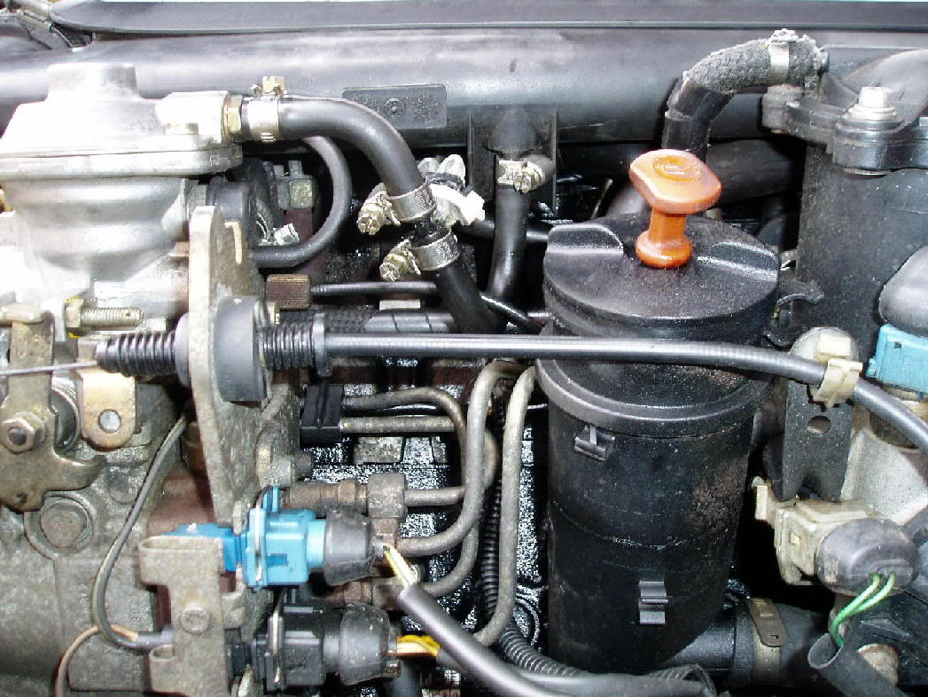

Your engine looks like mine used to! [:)]
A little warning: I sheared two of the three bolts holding the rocker cover on when changing my rocker gasket (following the torque setting in Haynes), so either be careful or get a set from Peugeot. They're about 20p each I recall.
My leak turned out to be partly the gasket, but also the breather pipe was split and letting oily fumes out. Not good. There was a bloomin' awkward jubilee clip keeping the filler neck in place so I had to have the starter motor off - pretty straightforward really, just three bolts. Worth it in the end though, my engine's spotless!
Best way to tell if you've fixed the leak is to invest in a bottle of Gunk or similar degreasant, and give the engine a good going over with a stiff brush. You can buff the rocker cover up nicely with it off, natch. Cover up the alternator and any exposed electrical connections and get a pressure washer on it. You'll soon spot any leaks right away after that.

<blockquote id="quote"><font size="1" face="Verdana, Arial, Helvetica" id="quote">quote:<hr height="1" noshade id="quote"><i>Originally posted by batwad</i>
<hr height="1" noshade id="quote"></blockquote id="quote"></font id="quote">
yeah i used GUNK on my other 306 and its come up aa treat.
got rid of all the crap by the injecors and on the sump
