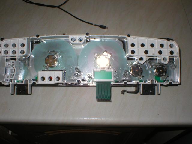

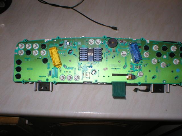

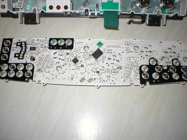

I've seen this once before on an S2 Xantia and was replaced by replacing the instrument pod. Rather a sledgehammer approach.
S2 Xantia instruments are all electronic and connect to the printed circuit board containing their 'works' via spring 'fingers'. These are notorious for making bad connections and affecting how the gauges read.
The good news is that with a bit of care the instrument pod will come apart - just watch the ribbon cable going to the LCD mileage counter - and that will enable the fingers and their respective pads to be cleaned.
Here's some pictures:
