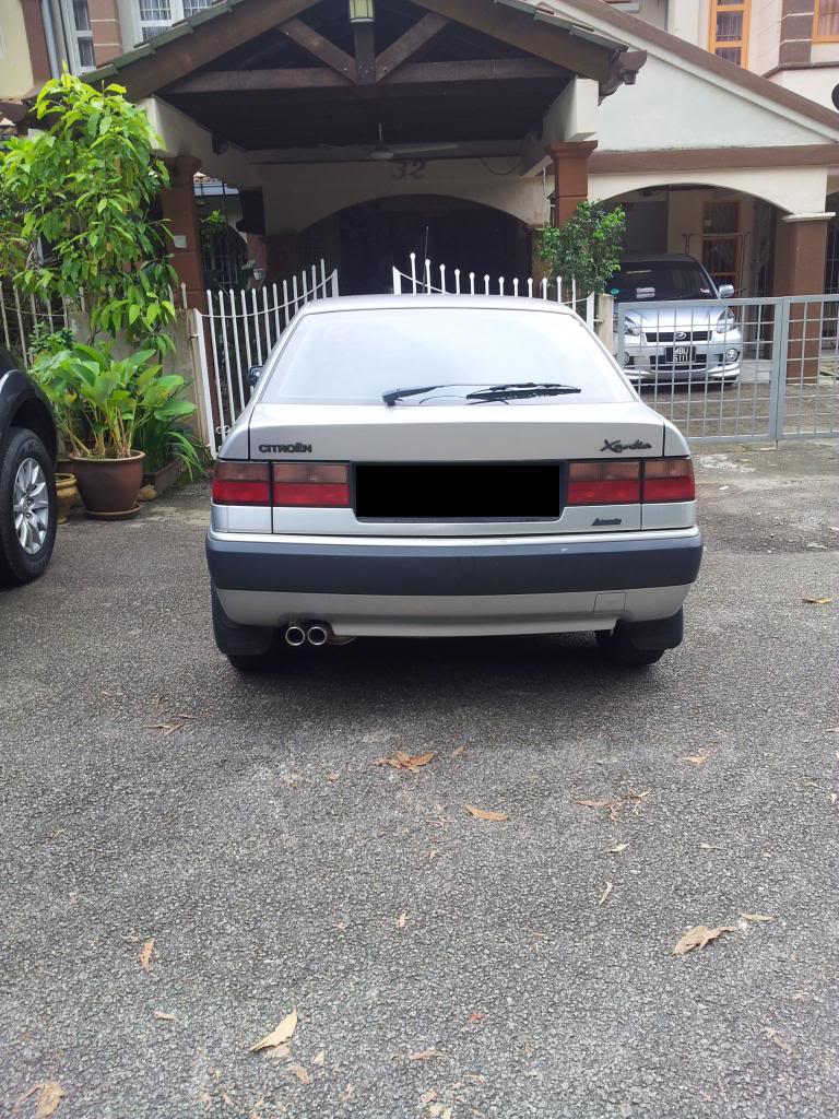

Your Xantia looks like new with your climate. We don't see many Xantias like that in the UK

The picture doesn't really tell the whole story, paint actually started to fade on some spot including the hood.. Getting a fresh paint next month, same colour. :D
