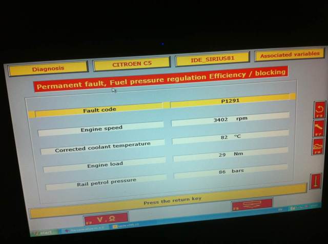

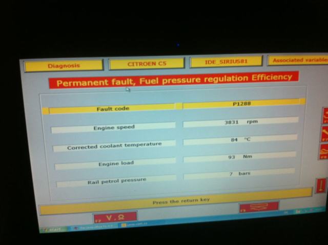

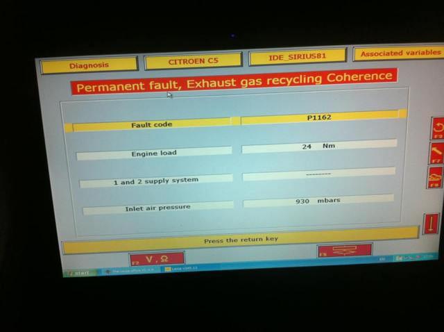

Success, Plugged it in and it worked just like that. Got some fault codes. I'm pretty sure the EGR valve has been replaced, so maybe an old code and also a couple of fuel pressure regulation fault. I'll post pics, to ensure I don't mistype a code.

xenton
- Posts: 91
- Joined: 02 Sep 2012, 23:14
Re: Problem on hard acceleration
Ah sorry, here they are in higher res:
Fault codes are: P1162, P1291, P1288

oneday
- Posts: 663
- Joined: 15 Aug 2012, 22:49
P1162 SIRIUS 81 - Exhaust gas recirculation. Coherence
P1291 Injector High side short to GND or VBATT - Bank 1
SIRIUS81 (EW10D)- Fuel pressure regulation fault. Output/Locking.
Fuel rail pressure. Low value received.2
P1288 Cylinder head temp sensor Out of self test range
SIRIUS81 (EW10D) - Fuel rail pressure. Low value received.1
mostly seem to be pointing to fuel rail pressure. looks like you need to look at live data on a run to try and find the cause of the fault.
