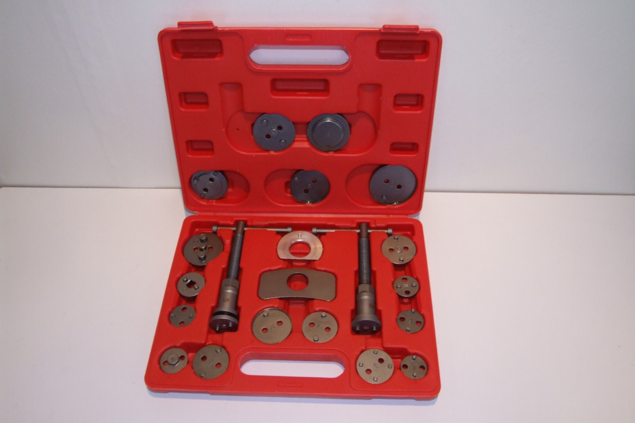

andmcit
- Posts: 4299
- Joined: 03 Mar 2005, 17:59
- x 30
Re: Xantia front pads
Dear Lord - don't go levering the front caliper pistons back they're not like the rears
or older Cx, Gs etc. I guess that's been established (hopefully) already here with
Richard's comments!!
You need to carefully wind both pistons back clockwise into the caliper whilst
facing to the rim with the 4 notches cut out. I have x2 wind back tools where the
just as expensive but really rubbish Halfords one is a poor relation to the far better
Sykes Pickavant one that I've managed to misplace.
Full sets of right and left
handed wind tools with differing adaptors go on ebay for £20:
http://www.ebay.co.uk/itm/BRAKE-CALIPER ... 2a24fc063a" onclick="window.open(this.href);return false;
This can't be any worse than the £30 Halfords pony version.
Just a month back fitting a set of front pads on my V6 Xantia showed the very
interesting different take on the other Xants set up, where the tool was so damned
useless I resorted the engaging the jaws of a decent pair of moleys onto one of the
quarters of the toothed caliper face and gently engaged them to wind the caliper in.
I didn't undo the bleed screw as I normally do and there more modest resistance.
I can see using a flat plate like an old used pad would work well.
When you wind the caliper in take care that the gaiter seal is even and folds without
any creases as to tear it when fully compressed home into the caliper housing. The
only other tedious part of the job that is essential to allow the caliper upper to swing
up is careful routing of the handbrake cable end through the eye shoulder once it's
stop end is unhooked from the actuating caliper lever. I find the tiny cable bellows
can put up a fight when feeding the cable out and unclipping the end of this bellows
off the ridge against the outer bowden cable will narrow the diameter a bit.
to allow it to feed through.
DO NOT buy one of these, even if it is the only thing available on a Sunday afternoon:
http://www.ebay.co.uk/itm/LASER-BRAKE-C ... 2eb9194807" onclick="window.open(this.href);return false;
