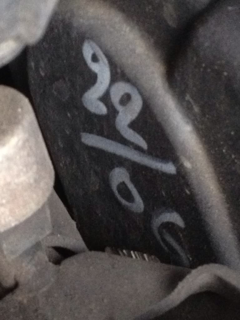

This is what's on my cambelt cover.
Car is coming up to 149,000 miles.
What would you do??????

Hi Steve I'd change it for piece of mind presuming the 06 means 2006! Pretty straight forward on the hdi.

That's what I was thinking. Not too hard a job?
I'm guessing that's a '99' and not a '22'.
100,000 mile service intervals?

Numbers could mean anything. If there's no record of a change, then it's well overdue.
