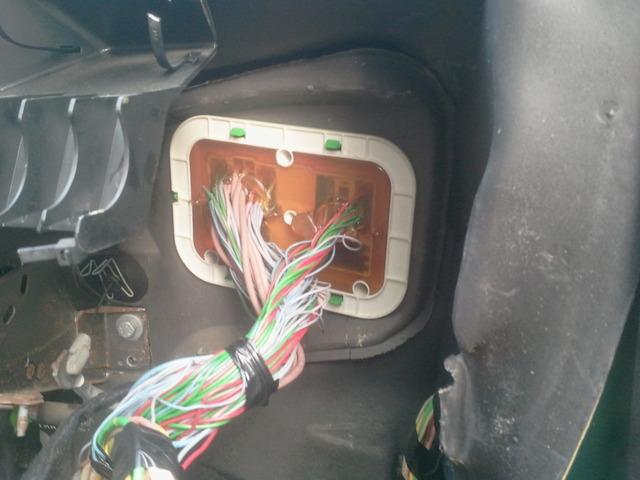

Undo this massive bulkhead connection:
so I can rescue the harness as much a possible!
Xantia interior MAIN loom through to engine bay in case you cant work out where or what exactley...

There's a couple of really deep torx screws IIRC Paul - took me ages to work this one out!

Have you exposed the other side, by pulling up the plastic cover in the scuttle corner?

Quite right Adam - it's undone from the scuttle side - didn't look at the picture long enough! lol

Yea been in there seen the screws got them out then what.. gentle persuasion or a little more heavy handed???

There's more screws to undo then - it WILL fall out when they're all undone - no persuasion is required!
I recall the exact same feeling about this as you have ATM!

Don't you then have to release the clip "fingers" shown in your photo, then extract the bezel from the scuttle side?
I'd imagine it then exposes the retainers for each half plug.
