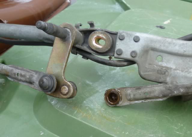

Right! I've got the assembly off the car and one of the ball joints has come apart. It pushes back together again but it wouldn't take much for it to come adrift again. Anybody know if it's possible to make a more permanent repair.

Since nobody has any experience of repairing faulty ball joints, I've concluded that it doesn't often happen so have gone for a breaker's one. I found a suitable assemby on ebay for £28 icluding P&P. Job done!!

Hi John, just curious. Was the ball rusty and corroded, or a lack of lubrication, or a worn plastic socket perhaps?

The ball seems to have rusted away. There was certainly a lot of rust in the socket, but nothing to hold it together.
