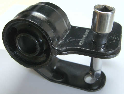

I have just bought P bushes for both sides. On one (see pic), the bolt mounting holes look severely misaligned by perhaps 4mm. The other is much better, maybe 1mm out of line.
Opinions please on whether assembly is feasible, or should one or both be returned?

Does the actual bolt go through the 2 holes if so it would assemble with a bit of brute force :shock: .
But you better off taking it back for another unit, take the bolt with you until you find one that is ok amongst there stock. I take it its a pattern part not genuine citroen.

An M12 bolt does go through off the car, but not clear whether it would assemble properly through the mounting holes. Clearly it could be bent to fit, but the 2 spot welds holding it together risk getting torn.
If anyone has recent experience, they might remember how likely it is to fit. Clearly I don’t want to dissemble the wishbone just to try it.
For the record, it came from AEP, maker Meyle, who have quite a good website with data sheets. Looks to be non OEM, but apart from the misalignment (!), fairly well made.

I have, in fact, decided to go with the parts I have, and see in the first instance (without the wishbone) whether the bush looks like pulling in. If it doesn’t, there is ample metal to enlarge the single hole and still allow the bolt head to clamp down solid all round.
