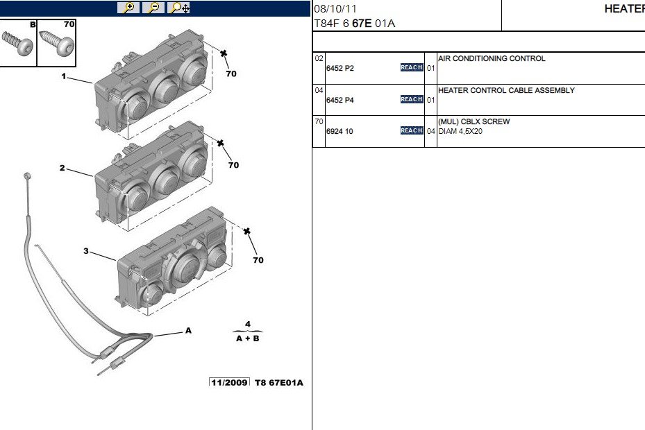

Re: 3008 heater directional flap control links
Hi,
I've had the s/h 2013 3008 a week,and went to renew the cabin filter.In the bottom of the cubby hole was a white plastic link arm,290mm long, that had come adrift.Any idea where it connects with please.
A drawing/sketch would help?
- Posts: 12440
- x 1432
Re: 3008 ventilation
If you post up the VIN (which will auto hide) we can have a look and see what you have got and where the links are.
- Posts: 42019
- x 6955
It's probably part of one of the reduction motor kits, but we'll have a better idea when you provide your VIN.

- Posts: 12440
- x 1432
There's nothing like that showing as a separate part
It does show a bowden cable from the control so this may link to where it should be
I looked on e-bay but couldn't see a heater box with enough detail to show where it might have come from.

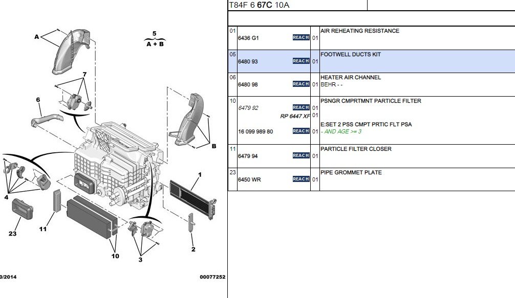

Hi all,
I would like to know where is the air intake (interior and exterior) I did try Google and other sites but could not find it. If someone has an air vent diagram or location would be very helpful.
Thanks
Thanks
- Posts: 42019
- x 6955
The exterior air intake is under the scuttle panel. If you require a diagram see below:
