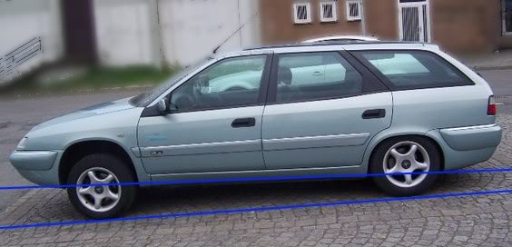

Edit: This one has its front high and rear lower than it should be
I found this pic from a site selling cars. I'm not sure if this one will give a good ride.
